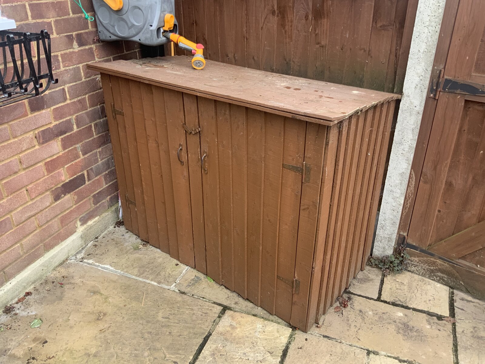

I made a store for our bins by making a frame and doors out of 3”x2” timber and then clad it with feather edge fence board.
