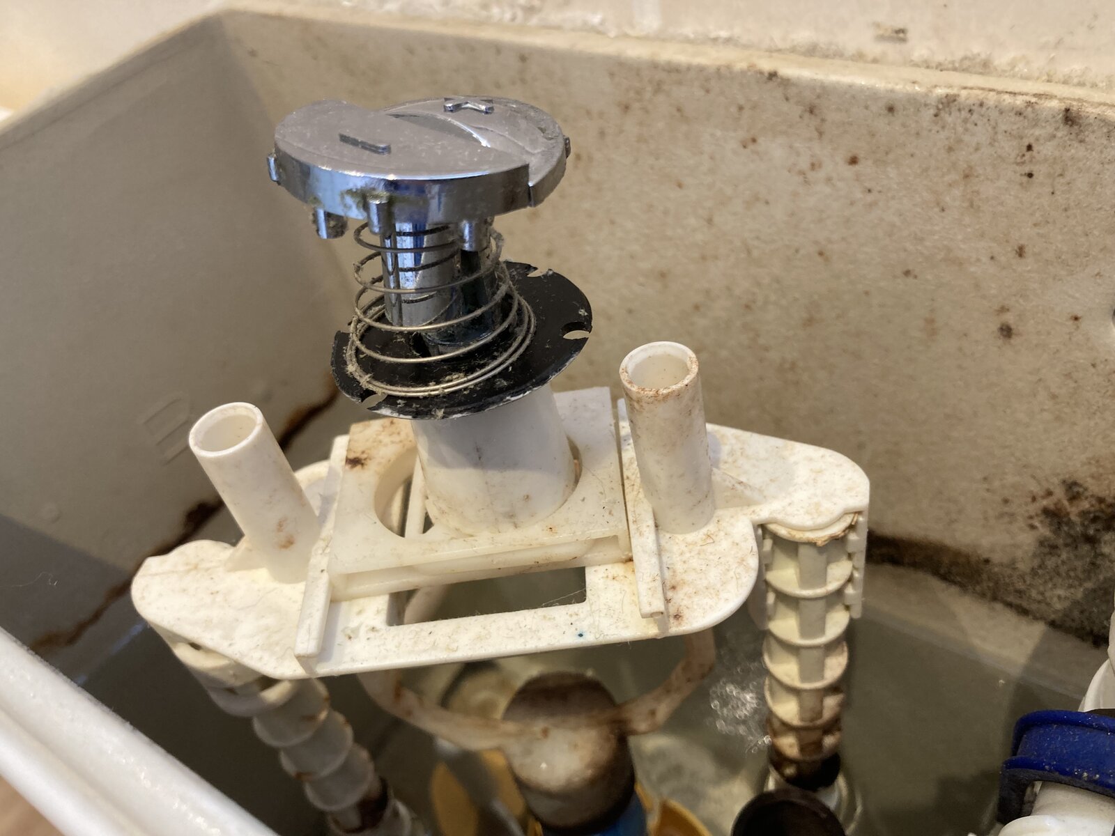

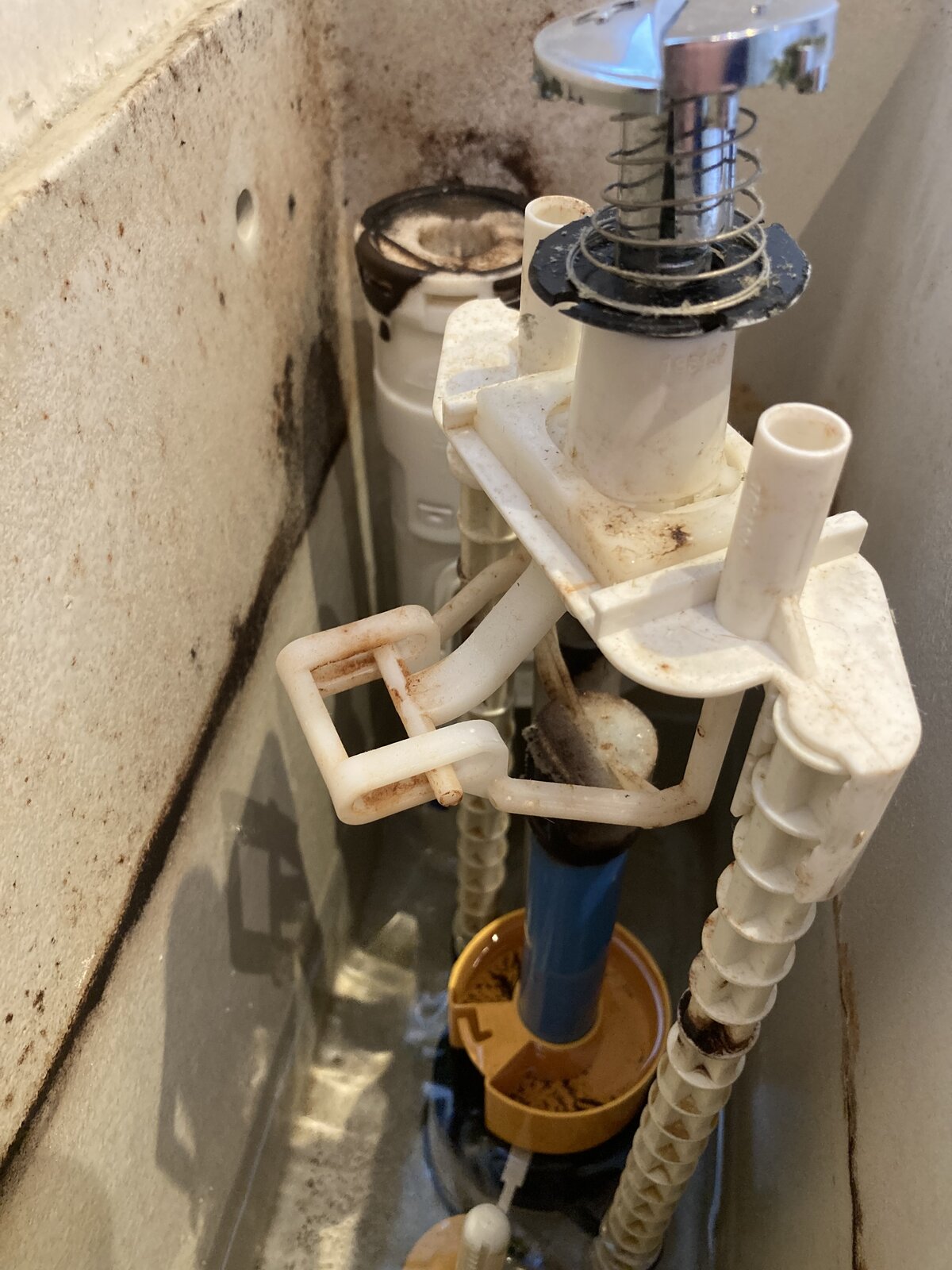

I have an older close couple lol from Qualitex ( Qx) and the flush button has broken and my wife has flushed away the chrome top ring and button guide.
So I’m left with this
so where could I get a replacement button and top ring ( to fit 52mm top hole in cistern)?
Qualitex do not have spared for this model ( Monica)
Yeah, I did see this, wasn’t sure if the button would retro-fit as the link is to the entire valve assembly .
Thanks, I’ll look into it tho.
This is what forums are for !!
Happy to report this button simply screws into the Rapide flush pefectly and was a one minute fix
The cost was high for a piece of plastic and a spring and it feels a bit cheap.. but it is so much less hassle than a replacement valve and/or paying someone to do the job, so well done MBD Bathrooms UK … you saved the day.
