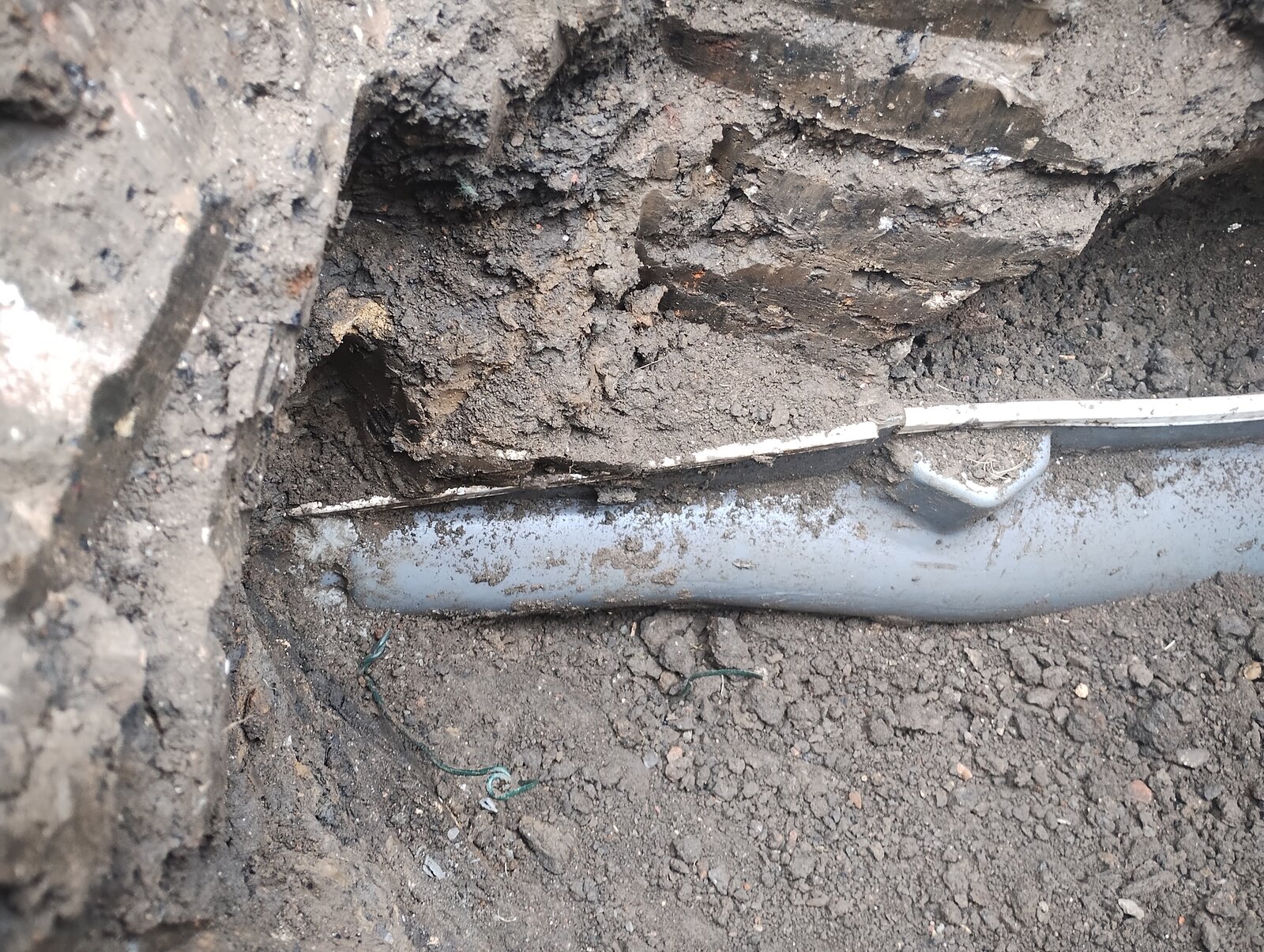

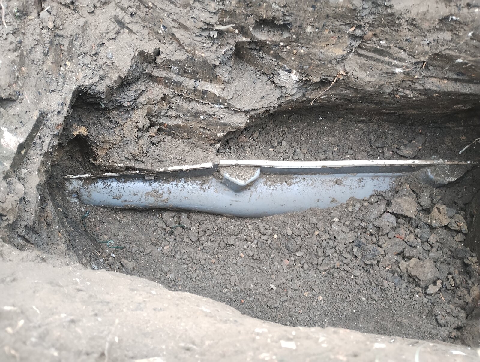

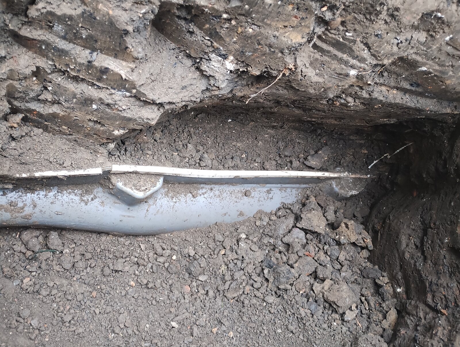

Hi
I m wondering if anyone knows what this pipe is .
After digging a hole for a fence post I come across this it's 3ft down and it's in the middle of my garden around 20m from my property .
It's a dark grey pipe around 5inch circular and has a fin on the top with a bizarre white trim on top .After the moulds on the top both sides taper down to 3 inches .
There's nothing on the deeds showing any facility pipes although the estate was flattened 30 years ago so it may be old and redundant!
Sorry if pictures aren't the best as I was wary of digging any further.
Any suggestions welcome many thanks

Looks to me as if it's a high voltage cable joint - something like..
Good thing you didn't dig through it, that looks a pretty hefty cable!
I have considered this but the white trim on the top seems so out of place ....Thanks for the advice it's much appreciated

That bulky affair in the image, is a resin repair sleeve. The cable is repaired. It is then surrounded by a plastic casing (with dedicated pour hole) and resin is mixed in bags and poured into the hole. You'll often see two or three blokes with a bag each in their hand 'massaging' the resin mix ready to pour.
