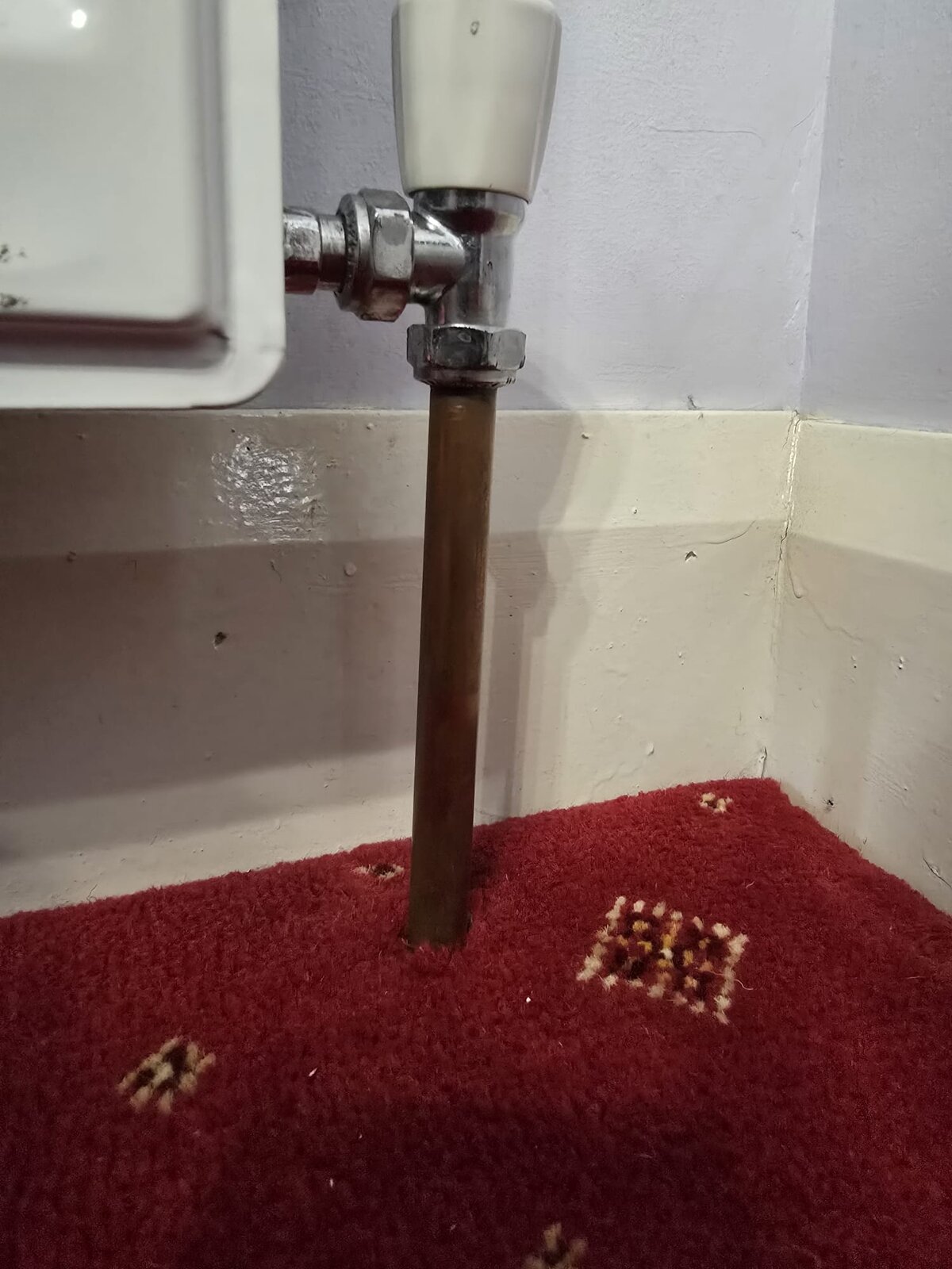

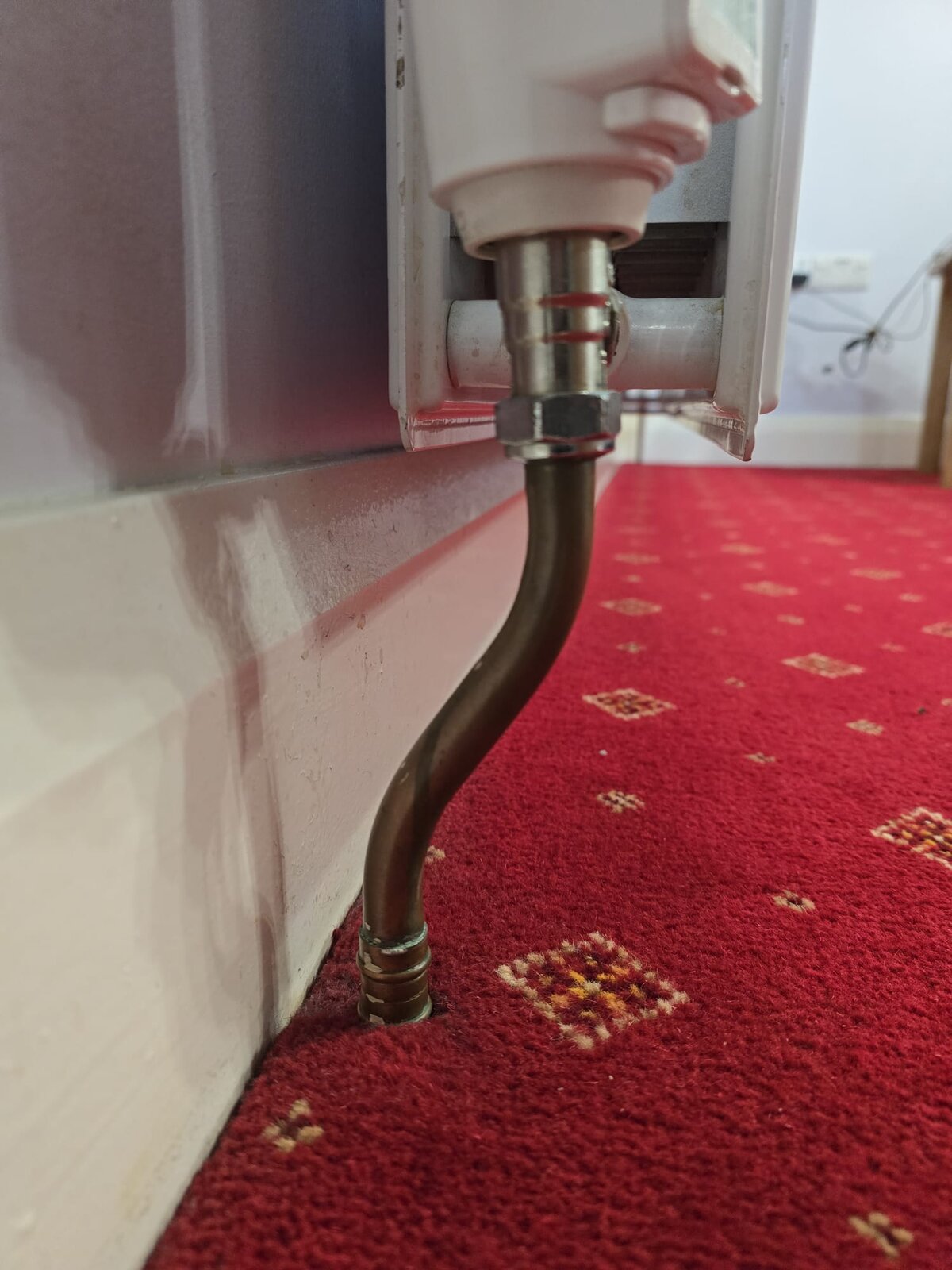

I have a single/one pipe heating system in my house and there is one radiator that does not get warm useless you wait a hour + , I have tried swapping a radiator for another known good radiator and the only difference I can see is the pipe work going into the radiator one pipe is straight and The other pipe as a S bend is that enough of a change to stop the radiator working ?
Actually yes - it can adds resistance to something that is already very sensitive to flow. Hopefully it is a pulled offset rather than a soldered one?

OK - it's still vertical and I would presume up above the single main pipe, so that should be fine.
Not touching the lockshield valves on any of the other rads, shut down the TRV/Wheel head valves leaving the troublesome radiator on - does it then heat up ok?

It's worked... so.this suggests thst it's got a bypass.
Lift the floor there you will find the bypass and fit a gate valve between the to feeds into the radiator. Throttle this down until the heat diverts through the radiator.
