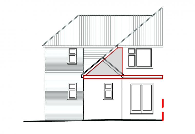

This is a little unusual for me and just wanted to hear out a few other more experienced builders than myself before attempting this.
I've got a 5.4m opening to create in a 9" brick wall. Haven't chipped off the render yet to see if the mortar is decent or not so cant tell you that yet.
Here's a pic
The red rectangle is where the beam must go. The grey area edged in orange is a section of brickwork I COULD remove as there will be a second storey extension going here. Ideally I don't want to take it out until I need to for weathering reasons etc.
The issues I can see are that there's no triangle of brickwork to support, just a whole section of wall and roof. Furthermore, I want to fit the beam at floor joist level (beam runs parallel to joists so can sit next to the last one). Lastly, this beam is going to weigh an absolute ton meaning man handling it into position will need a team of burly blokes and fairly decent access. Is there any type of equipment that's recommended to lift the beam?
I was planning on positioning Acros either side at 900 centres and needling the wall above. I've got a bunch of Strongboy props but thought that perhaps these wouldn't be man enough for this particular task.
Any thoughts on best approach would be much appreciated.

I am sure if you have done any serious building you know that it is not at all realistic to agree or otherwise with your proposals without seeing the actual job and understanding the structure as a whole.
For such a large opening You should ask the SE to tell you what size steel to use (as approved by BC) and to give a sequence of operations to install it safely.
As for lifting equipment, use a mobile crane! It will get the beam straight off the back of the wagon very close to where you want it before using the temporary supports you will require for final positioning.
A classic case of the need for a method statement.

The experienced builder can put a method statement together, but so can the experienced SE. especially with regard to maintaining stability of the building while the opening is created and the beam put into place.
The use of scaffolding and props to support the beam as you move it into position is something to consider especially if you are able to slot the beam in through a temporary hole close to where you need it. Once in, maybe adjacent to the final location use levers to inch it into position.
You really need to show plan and elevation of where the beam goes and add information such as working space available. Then maybe the experienced builders can give you a few tips. Wait until you have the weight and dimensions of the beam before posting back.

Right the SE had specified a 203 UC 71 with my point load beams bolted to it. This leads me to my next question. On the drawings he has specified a 10mm thick mild steel end plate welded to one of the adjoining beams. It also says F.P.F.W + 4 No M16 bolts. What is F.P.F.W?
Full Penetration Fillet Weld.
Considering the central point load, his beam spec. seems about right.
You also need to check the bolt grades with him - 4.6 or the higher-strength 8.8?
Bolt grades are the higher 8.8. Because of the loading on the beam and the walls not being too great, he's specified that the beam be supported by UC's at either end buried in the walls. I've also got to dig up and put new foundations in but I'm waiting on those drawings early next week. He hasn't specified how the beam is connected to the columns though so I've asked for a detail of that.
