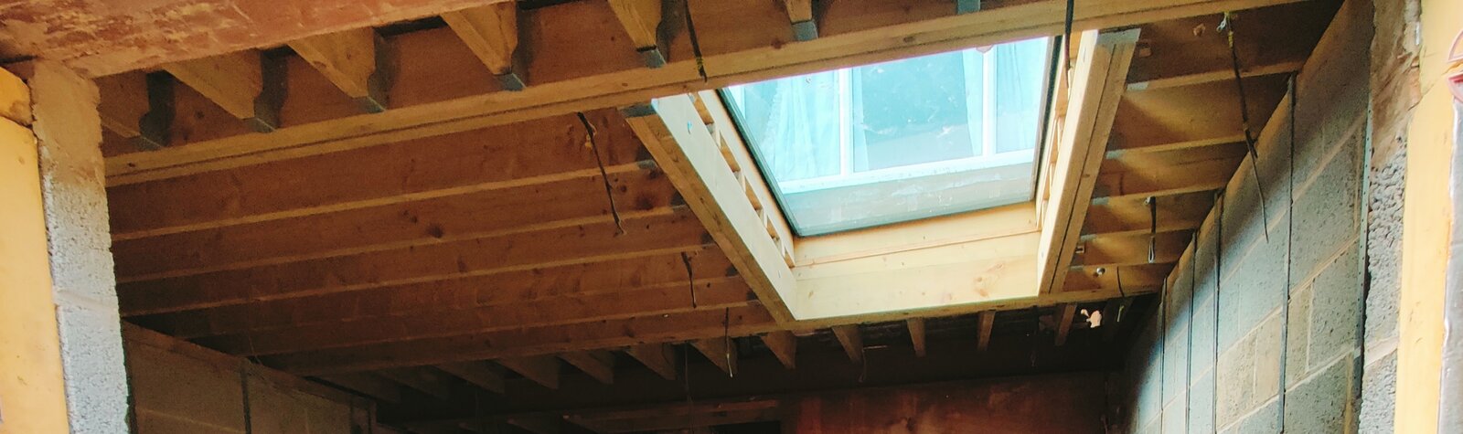

After sorting out our ventilation issue in our flat cold roof, we are now at the point of putting in the insulation.
I am hearing contradicting things at the moment, that we need to use gapotape due to the recent changes in building regs. or can we simply ensure the celotex is cut correctly to size, and any gaps are closed using expanding foam?
Our plan is to the do latter:
We have 7*2 rafter joists, with a 23m^2 area space (25m^2 - 2x1 skylight) see image attached.
We have the following:
- 120mm Celotex
- Expanding Foam
- Aluminium foil tape
- SFTV Reflective vapor membrane layer
- Double sided Butyl Tape
Do you guys think this approach is okay, or do you reccommend any other adhering to the new regs?
I filled the gaps with expanding foam, then aluminium duct taped all the joints. This passed the inspection.
Is 120mm Celotex sufficient for 2022 building regs?

We have 7*2 joists, so 120mm should be sufficient to ensure minimum 50mm air gap - is that the case?
No. The insulation thickness is paramount and should not be sacrificed in order to obtain a certain air gap size. Where a joist or rafter is not deep enough to accommodate both the required insulation thickness and an adequate airgap, one is expected to fix knock-on pieces to the joist or rafter.

You will likely have to under-draw the ceiling with another 50mm of insulation, prior to plaster-boarding.

Hi Noseall, thanks for getting back - I'm abit confused though, so you think 120mm is not sufficient enough?
As stated:
- 7*2 joists
- 120mm insulation
--> Remaining air gap once insulation aligns with joists approx 55mm
Opting to apply:
- Expanding foam to any gaps
- Vapor control layer/barrier (specifically SuperFOIL SFTV Thermal Vapour Barrier)
Your input in regards to the process and what you expect we should do would be greatly appreciated, as I really would like to get this right first time. Thanks again.

You are right, 120mm is not sufficient for the cold roof system, I have just confirmed this on the phone with my building regs contact.
He confirmed your suggestion to append an additional layer of insulation to achieve minimum thickness of 150mm.

Once you have fitted your first layer of insulation, apply foil tape to the joints and/or squirt foam to the bigger gaps. Fit the second layer across the joists and foil tape these joints too.
Finish it off with duplex plasterboards.
