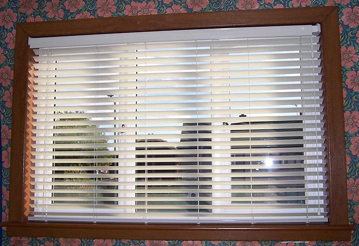

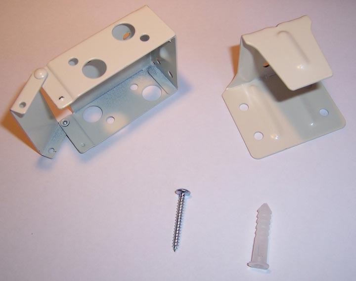

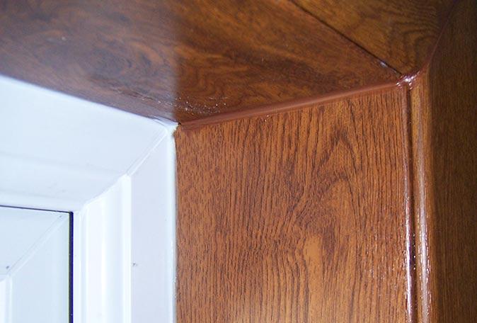

I have just purchased a Faux Wood Blind from Blinds2Go and am about to install it myself - but I have a slight concern re attaching the brackets to the window recess. My window recess is a wood impression of some kind (please see photos) and I wonder if I should just screw into it with the supplied 30mm screws. I have been supplied with 30mm rawl plugs also for fixing the brackets. I am not sure how thick the window trim material is or what is behind it - but on knocking on it, it sounds fairly hollow sounding. I am wondering what is the best thing to do. I am concerned about getting a good secure fixing of the brackets as the blind has a fair weight. There are 2 side brackets and two additional support brackets (please see photo). As regards the rawl plugs I am not sure if I should use them for screwing into the wood type material of the trim?
Can anyone advise, thank you.
Looks to be plastic [wood effect] I would use a short 20mm screw, if the longer screw hits a solid background it could force the trim off the window.
No wall plugs required. There is always the chance it could pull loose if the trim is not firmly fixed, but you can't be sure till you try.The bracket could be secured to both top and side reveal to make the fixing more secure.

I couldn't find Flange Self-Tapper of size 8 x 1", only 6 x 1" or 8 x 3/4".
I need the 8 x 1" for the top-fixed middle support brackets, as I need a spacer to level them with side box brackets, so a longer screw is needed.
I was going to use 8 x 3/4" self tappers for side box brackets but if I hit anything I will try 8 x 1/2" size instead.
I am not really sure what is the difference between self-tapper and wood screw? Can wood screw generally be used on wood impression type materials ?
Self tappers cut their own thread and are generally harder than wood screws.
Either will be ok .

That's it - the brackets all seem perfectly secure, I used the 1" wood screws, and I got the brackets dead level with the spirit level. The only problem now is the blinds leave slight gaps between slats when fully closed so I will need a curtain as well, otherwise they are decent blinds for the price £90.
