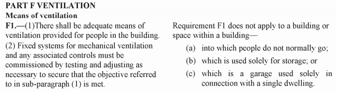

One it is unusual to have a transformer with a low voltage fan, most are 230 volt, you can get extra low voltage fans, often with a extra low voltage lamp in the centre, I fitted one in the bathroom here, it is still there, as it was too big to remove without removing ceiling, so now only three lights and a fan which to be frank is hardly ever used.
If the fan is within a zone which requires extra low voltage then OK, other wise keep it simple and use 230 volt. The same applies to lights.
As to fan operation it should be ideally able to be switched on without the lights, the old building regulations required it if there were non opening windows. But it seems to have been now dropped I assume as energy saving bulbs use that little power?
The problem is where a fan is required by law, it is also required to run on, and although you can use double pole switches and have it so it can either be worked with lights or independently, normally people select one or the other, not both.
The debate is will the fan ever be used if not with the lights, or reverse will anyone switch on the lights during the day just to run the fan, and of course is the fan required?
I don't think the law comes into it.
That is all the law says.
Indeed not - and nor is there any way that the law can force house occupants to actually make use the "provided adequate means of installation", particularly when it takes the form of an openable window. Even if what was 'provided' were a lights-connected fan, it would probably not get used during daylight hours if there were adequate daylight in the room - and, even when the room was dark, those who, for example, didn't like the noise of the fan might take a candle into the room with them :)
