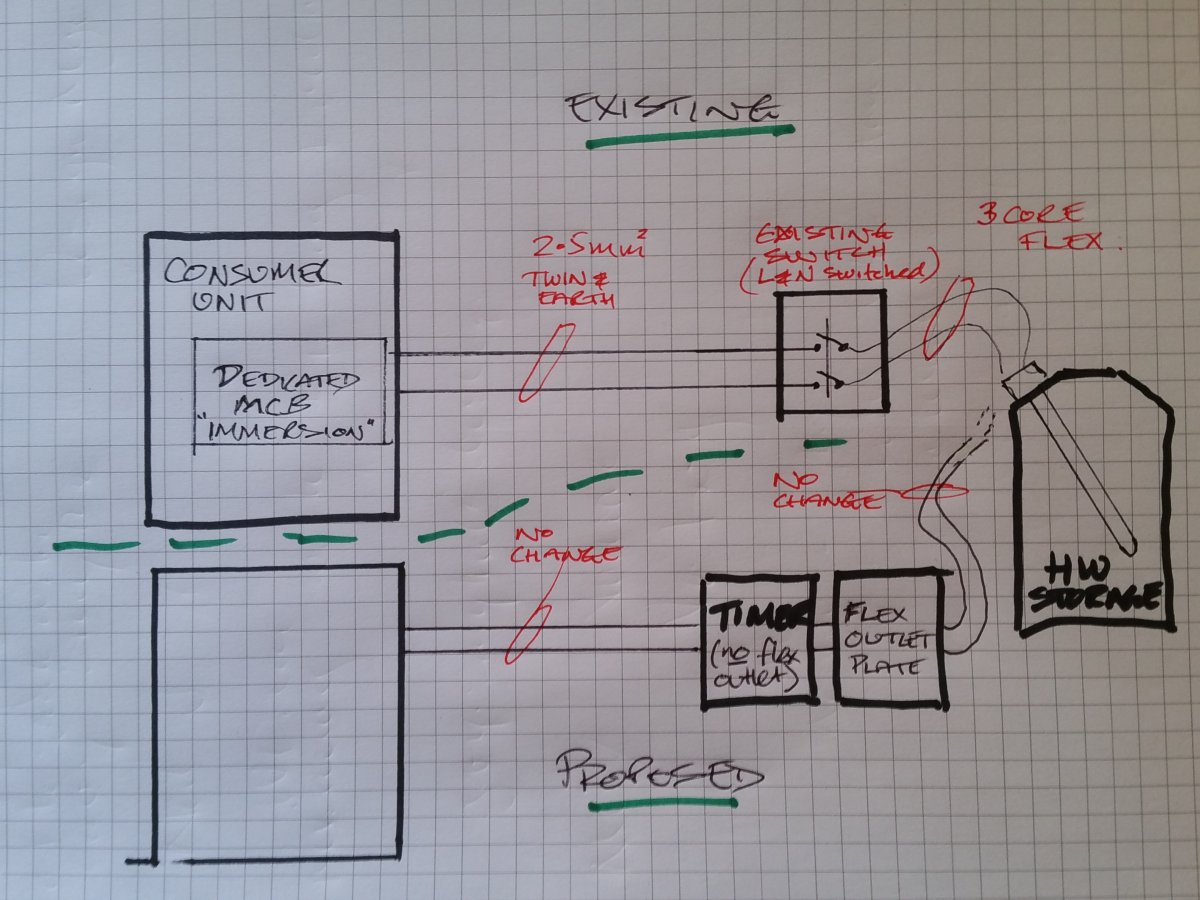

I want to install a TimeGuard inline immersion timer (model NNT03 as here: http://www.timeguard.com/products/t...ompact-electronic-immersion-heater-timeswitch ) in the airing cupboard, for summertime immersion control (use boiler in winter). This timer required no separate power supply, deriving power for it's circuitry from the supply it switches.
At present, immersion heater is fed from a dedicated MCB in the consumer unit, to an unfused dual pole single throw (DPST) switch with flex outlet, located in the airing cupboard.
I propose to do a straight swap, new timer for old switch.
Question: Is this acceptable and still compliant to regs?
I have checked PartP guide and BS7671 and can find no clear guidance.
(Small aside, the TimeGuard has no flex outlet and no flex clamp to relieve strain, so I will need to add an unfused flex outlet plate between the timer and the existing heater flex).
My reason for my question above is this: If the timer were to fail catastrophically (fire) it might not throw the MCB (or would it?). But clearly a low current fuse to protect the timer will not allow the immersion to operate.
Limitations: The wall space I have will only allow two single patresses.
Not sure if my sketch attached to original post so here it is again.
If you provide an external flex clamp - fairly easy to make - then you could retain the switch while adding the timer.

I did basically the same job on friday, but there were two immersion heaters. I used these timers, which have built in strain relief
I was lucky that they were wired into a stud wall, so I could keep the existing switches, fish in the wall so the cable came out by the bottom cable entry, and then out to the immersion elements.
You could just loop out of the current switch, into the timer, then back onto the element
For strain relief you could use these and to keep your cables tidy too.

The other way to do it is to leave the DP switch in place, butt another 32mm pattress up to it (of the PVC variety) to fit the timer to. Why PVC?
You can fit a gland to provide the strain relief.

It is designed to go into a recessed or surface box. Exactly the same as say a socket or a light switch. None of these have strain relief for the cables themselves. Strain relief would be a function of the enclosure that you select.
