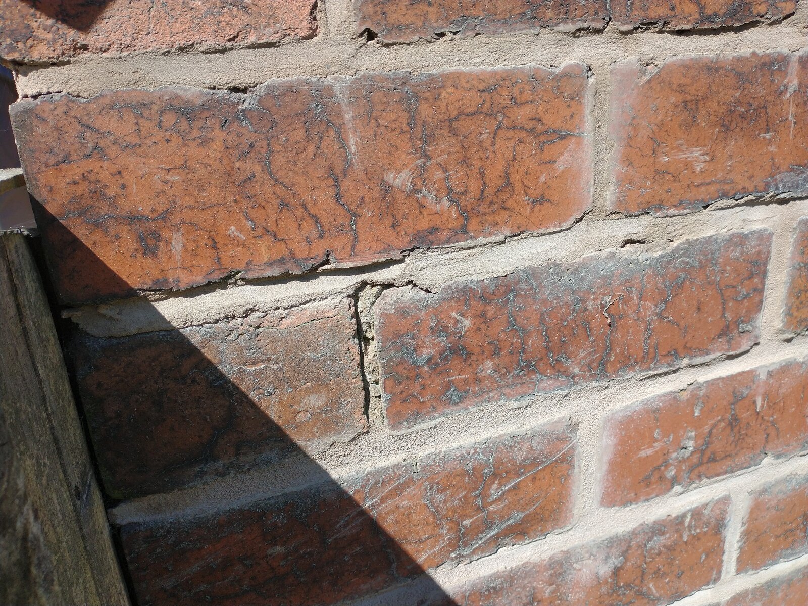

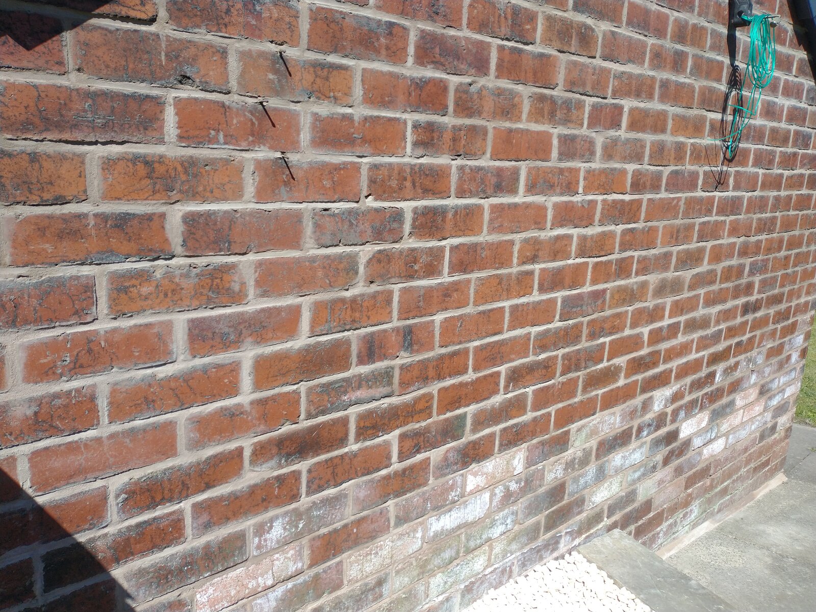

Here's a job my neighbours have just had done by a "professional" with a smart van, no raking out and he appears to have just smeared mortar on top of the existing, but as others have said what can you say when the neighbours think he's done a fantastic job?

I wouldn't imagine it's cost effective to pay a bricklayer for what is essentially semi-skilled work.
No pointing is skilled and very important to get right, and is not just running a trowel or jointer across the joint.
Ok. Specialist pointing and re-pointing of historical buildings and stonework etc is highly skilled work, which I suspect 90% of today's bricklayers couldn't do. Bucket handle pointing of a modern house with sand and cement mortar is semi-skilled work that can be successfully done by a diyer with the required attention to detail, as many on here have demonstrated.
