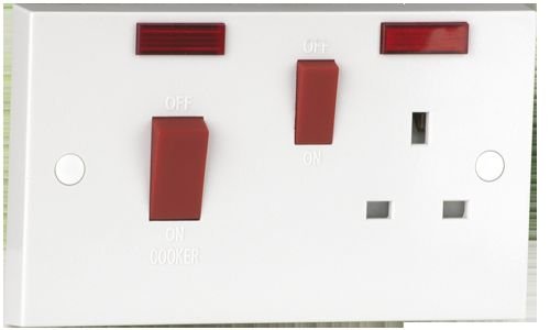

I have ordered the 2.5mm Butyl cable from TLC so as I understand, I have these options:
1)
32A MCB (As it is now) ---> 6mm2 T+E ---> 45A Cooker supply socket with extra socket for hob ---> Direct connection from back of this socket to oven in 2.5mm2 Butyl Flex.
2)
16A MCB (Change from 32A) ---> 6mm2 T+E ---> 45A Cooker supply socket with extra socket for hob ---> Direct connection from back of this socket to oven in 2.5mm2 Butyl Flex.
Option 2 means opening up the CU and changing the MCB which i've not done before. If i DO do this and leave everything else the same including the 2.5mm butyl cable, then are all the other components in the chain correct? (i.e the 6mm cable and the 45A socket?)
Option 1 for all intents and purposes is correct from what people have said, but it is not necessarily to "done thing", is that right? But it's perfectly safe and it's a very unlikely scenario that it would be a problem. If i've understood all that correctly then it's much easier for me to go with option 1. If someone can confirm this (again!), that would be great.
Yes.
No.
It's less than unlikely.
Yes, there is no doubt.
Also if anyone is wondering, I knew I oversized the circuit for my current needs, but the oven I'm putting in now will only be in place for a short while before I gut the kitchen and build an extension and have a much bigger double oven or 2.
When you do that you can connect it to the same outlet.
A much bigger double oven consists of the same parts; just more of them.
1) 32A MCB (As it is now) ---> 6mm2 T+E ---> 45A Cooker supply socket with extra socket for hob ---> Direct connection from back of this socket to oven in 2.5mm2 Butyl Flex.
2) 16A MCB (Change from 32A) ---> 6mm2 T+E ---> 45A Cooker supply socket with extra socket for hob ---> Direct connection from back of this socket to oven in 2.5mm2 Butyl Flex.
Yep, the only difference being whether you stick with the 32A MCB or change to a 16A one.
Yep, but unless you have the knowledge and skill to be competent and confident/comfortable to be opening up the CU and changing the MCB, you probably shouldn't attempt to do that yourself.
I wouldn't personally say so. The great majority of cooker circuits are 32A (sometimes even higher), yet I rather doubt that people often use flex larger than 2.5mm² to connect 16A (or lower powered) cookers/ovens to them.
As you have observed, opinions (about 'extreme cautiousness') vary, but I would personally be totally happy with it.
As above, I would say that a 32A/6mm² cooker circuit was by far the most common one comes across, so I wouldn't say that it is really 'oversized'.
Hope that helps.

Good, thanks to both again, I think we can put this to bed with option 1 and be done as dusted! Thanks
You're welcome. That's certainly what I would do. Even though I would be comfortable changing the MCB, I wouldn't bother.
