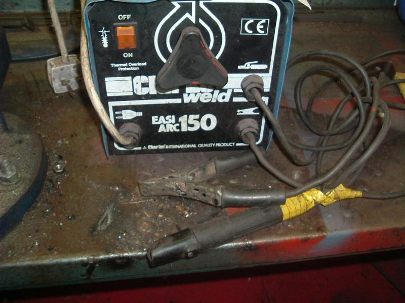

Had a guy in today at work to do the annual PAT on all the equipment. I was asked to get it all together for him and while doing so noticed a few things we rarely use that I thought would be definite failures.
For example, 2 halogen site sets which didn't have lamps in them and didn't have the retaining screw in the lens's. A fast heat soldering iron which was loose in the casing, (the type that looks like a little water pistiol), and a solder pot with a damaged socket where the cable plugs in.
Finally a small 240v welding set,
After he had gone I was asked to put all the 'passed' equipment away and the failed stuff to one side for possible repair/replacement.
There were no failures!
He had passed everything!
Would you use any of the above equipment? I certainly won't and have advised the boss to scrap them off and get replacements. His answer was, "Well they've been passed off as safe so I don't see the problem."

What is the yellow tape there for?

I would have passed that welder on a visual.

The yellow tape is apparently to hold the cable in place! (i.e. its the cable grip!)

The welder was put into quarantine over 12 months ago by myself but I was told to get it out and get it tested, then 'when' it failed they could declare it as scrap. So much for that idea.

The tape is on a part of the machine which is an isolated supply not exceeding ELV. It is designed to be safe to touch whist the machine is in use, so what is the proplem with having a bit of tape to stop the handle from flapping about?
If you are really bothered you could put a new electrode holder on the end, but it's certainly not destined for the scrap bin.
It is still in working order but what you can't see from that pic is the state of the rest of the welding cable and the mains lead which had pvc tape wrapped around a split in the outer sheath. It is fixable, and probably at a 'not too expensive' cost, but what amazes me is that the guy passed it because it showed up ok on his tester. His visual examination obviously didn't count.
A generic issue of inexpert repairs carried out? I take your point about the voltage (even though my welder has an 80V output option ;) )
Indeed not, but I'm not sure it should be kept in service in its existing state.
