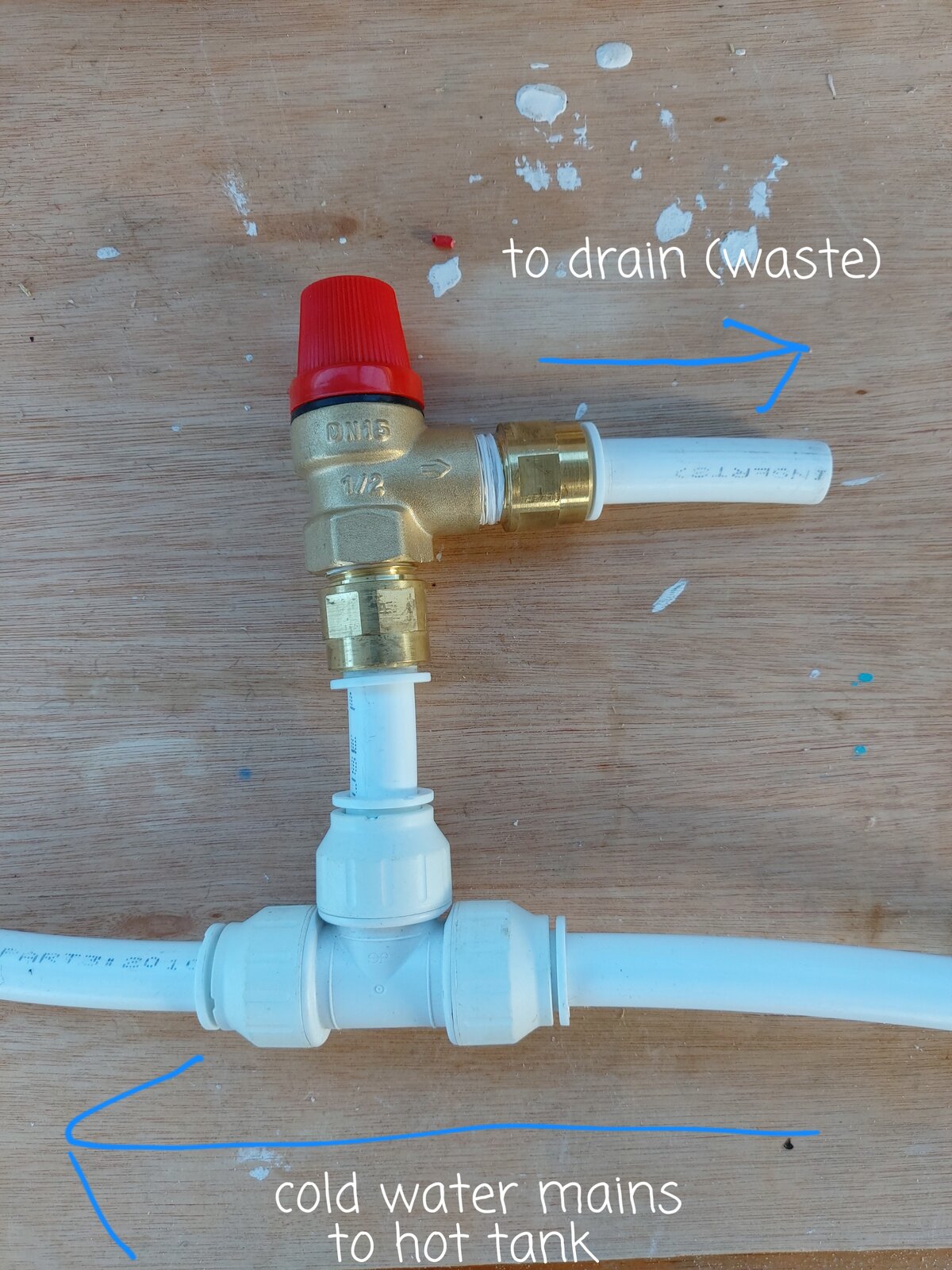

Hi
Just installing a water heater for a boat that's fed from a 3 bar water pump (12v). It's a 30l tank with a 2kw immersion heater in. Fitting a pressure relief valve and expansion vessel but have a couple questions..
do these both go on the cold pipe that feeds the heater tank? I've seen examples of them on the outlet, but always thought they on cold feed?
does it matter which one goes first along the pipework? I was going to do expansion tank first, then relief valve nearest to tank.
Is this the correct way to fit the pressure relief valve? The top pipe will then just drain overboard.
Cheers
It's usually to absorb the expansion back into the cold water supply. Follow the MI, it'll very clear about where everything is to be located.

Thanks for reply Madrab. It's a private recreational boat (cabin cruiser), not residential in any way, so I believe it's only governed by Boat Safety Scheme, rather than building regs (but obviously want it done safely regardless).

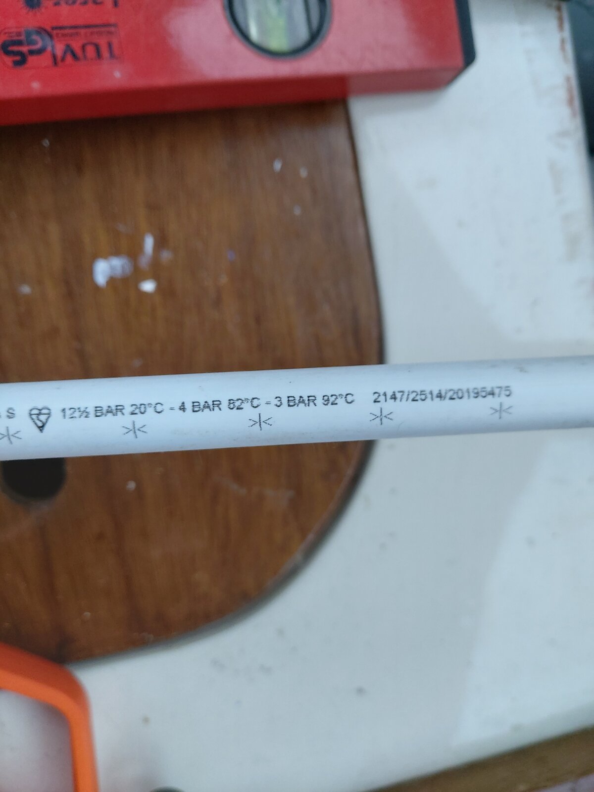

I don't think plastic pipe & fittings are an issue. I've hired narrow boats from companies such as ABC that use plastic, they're bound by much tighter regulations. They also have hot water systems that produce much hotter water than mine will be capable of with more powerful freshwater pumps. I believe the PEX barrier pipe can withstand 92⁰c at 3 bar?

If it's JG PEX barrier pipe then it's (82@ 3bar on CH) 95degC @ 6bar extended on HW, some other pipes have a lower temp/time tolerances, that's why I mentioned it. I only query these as it would be the things that would occur to me as an UV installer having installed a few of these and they usually prefer copper.

Thanks, yes it's JG pipe..
I'll check with local BSS inspector first, but pretty confident plastic is ok.
