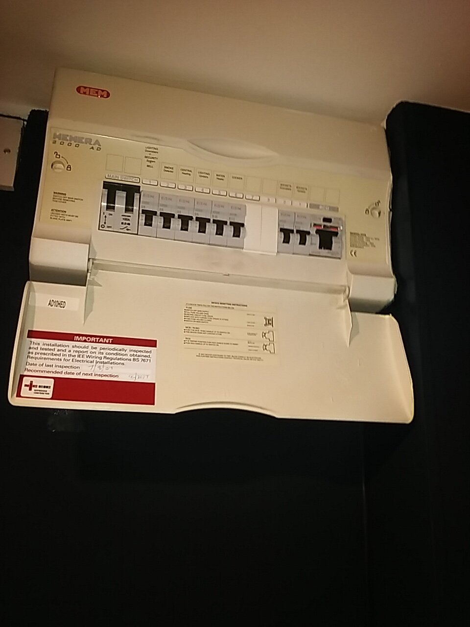

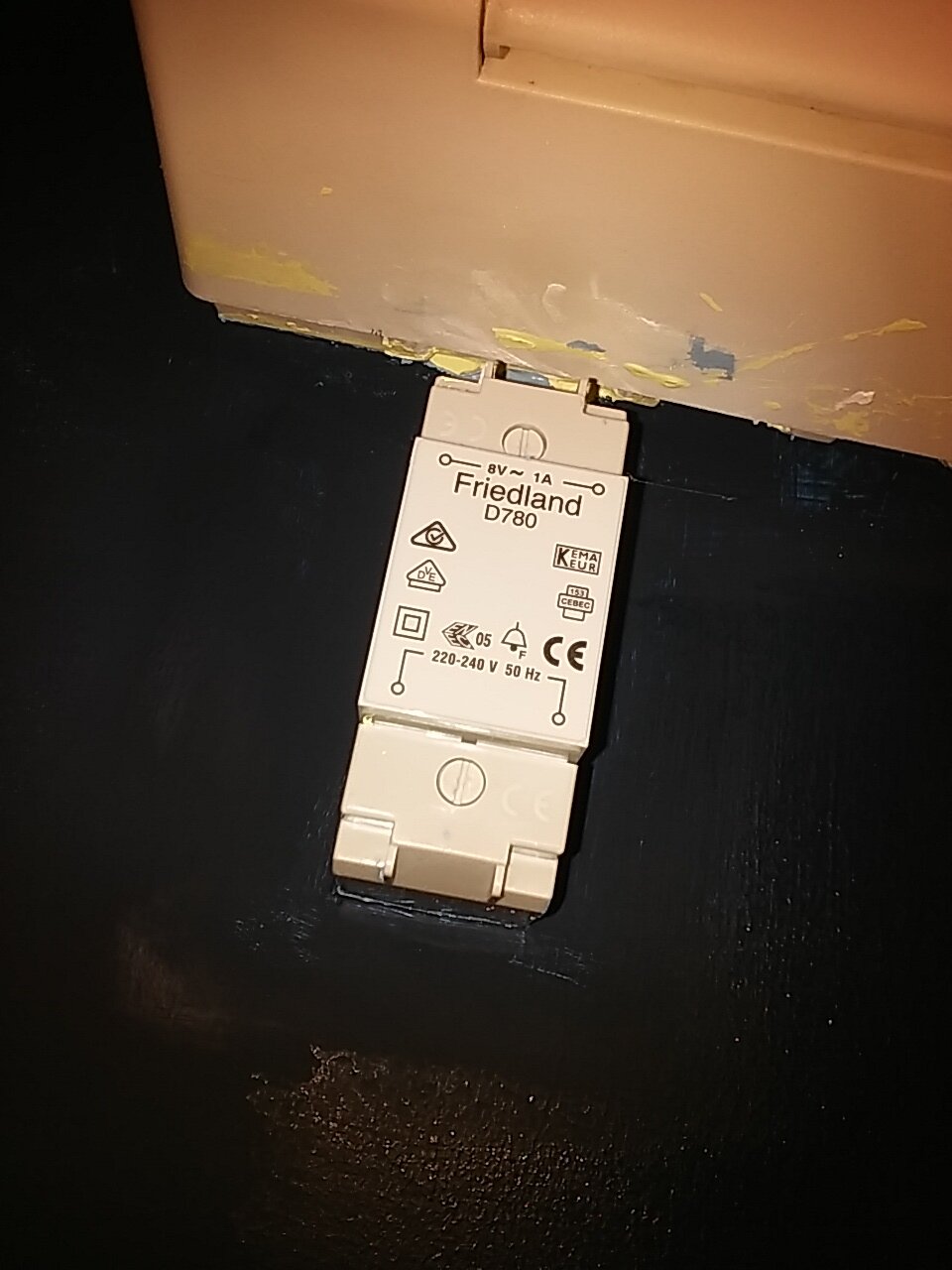

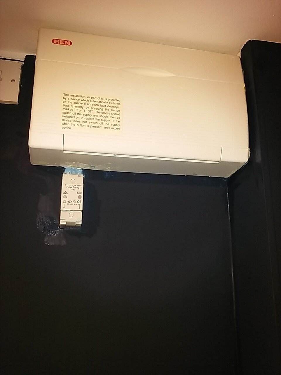

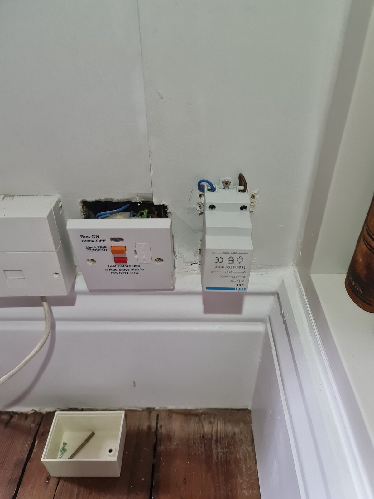

Just moved and inherited this. It 'dings' but doesn't 'dong' and is as loud as an amoeba sneezing. I want to replace it with a modern wireless job. However, it has a transformer under fusebox, fed from fusebox. How can I disconnect this so wiring's dead?

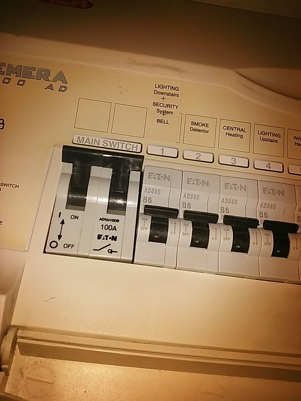

please show a full pic of the consumer unit, including all the MCBs.
One of them "should" feed the doorbell transormer, probably a B6 breaker, same as for the lights, and this should be labelled.
You would have to open the case and tinker inside. Are you safe and willing to do that? If not, get a qualified electrician.
The way it has been done may be unsatisfactory. It is more usual (but not essential) to put a fused connecton unit outside the CU, and feed the transformer from that.
in the meantime, you can adjust your ding-dong. Post some pictures of it, with the case open.

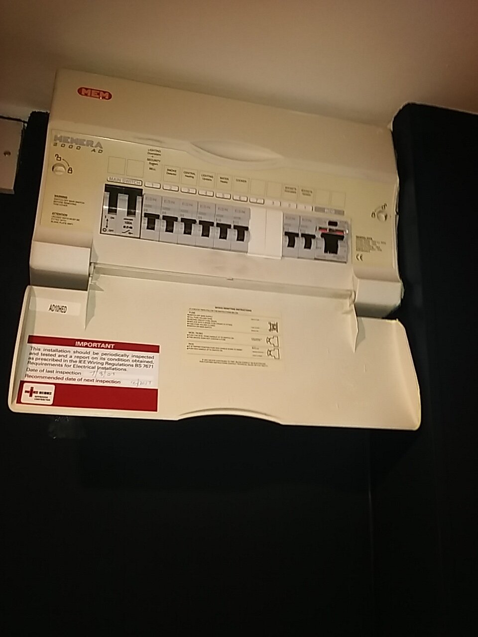

Hi John
Thanks for reply. Thought I'd attached some pics. Couple more attached.
Revitalising the old bell isn't an option, so I need to isolate it.

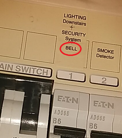

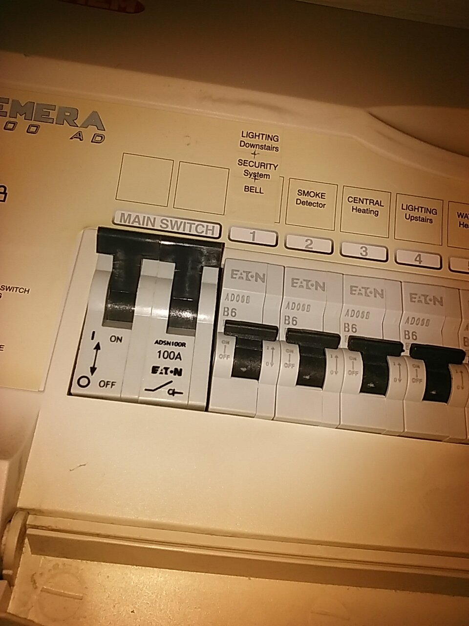

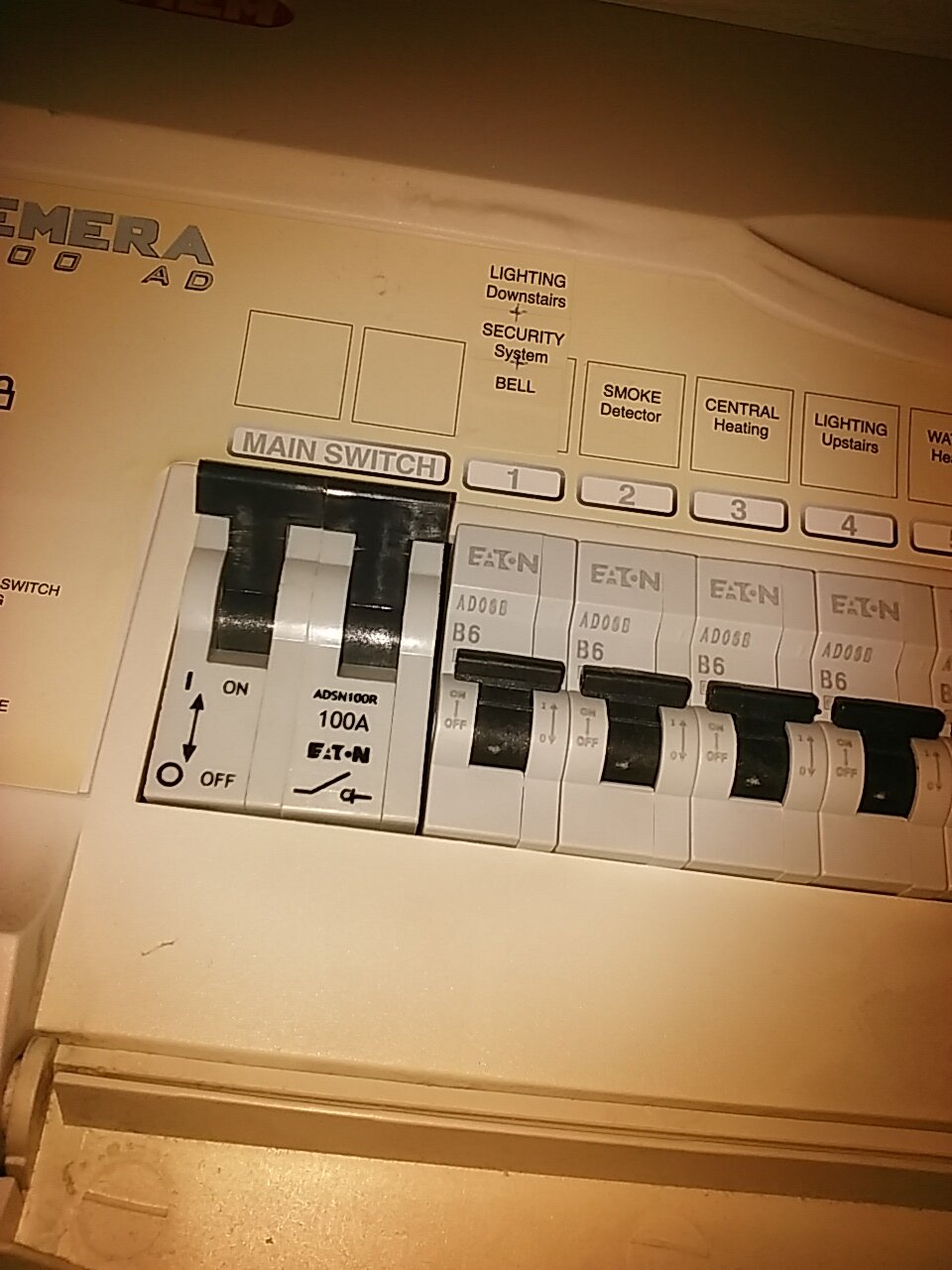

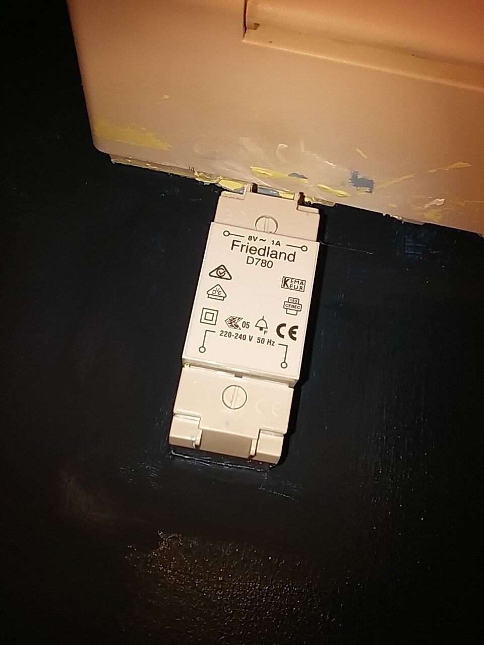

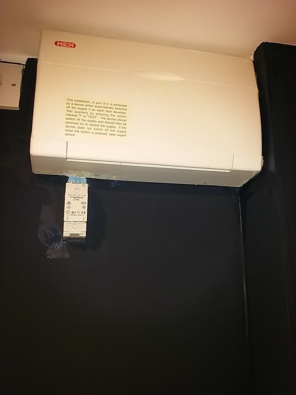

I want to remove or remove the wiring to the transformer, and therefore the bell on wall, not turn off the bell at the fuse, because then I also lose the alarm and lighting! I wondered how is it wired and or what happens if you unscrew the two screws on the front?
I ask because I cannot find any info on the net. :(
Then you have to disconnect the wires from where they are connected in the consumer unit.
If you unscrew the screws on the front of the CU, the front comes off.
Switch off the Main Switch first - but be aware the wires to the main switch will still be live.
It certainly looks as if it connects to No 1 MCB, which suggests it will be quite 'busy'. Hopefully you can follow the wires to the consumer unit and just disconnect the bell transformer and leave the other two circuits in place.
All I can add is, do not blindly believe the stickers on the consumer unit. Where I am currently working, none of the stickers are truthful.

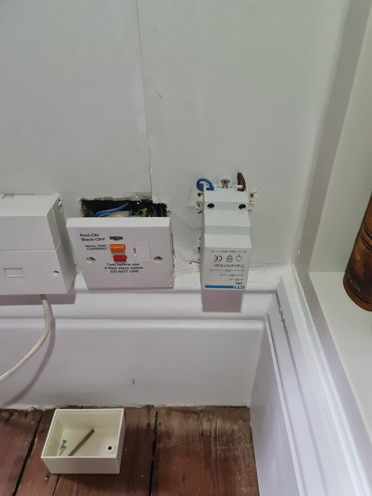

Funnily enough, I recently had to move their ring doorbell.
The "electrician" had left this
(I undid the RCD).
I had to move the ring doorbell by about 6 inches on the outerwall and ended up using the old door entry transformer. The customers were in the house and working.I flicked all of the obvious MCBs bar the one labeled "top of house". In the end I had to work on the feed live. As an aside, I then noticed that the metal back box for the RCD is not screwed to the wall...
Might it be the case that the existing doorbell only dongs rather than ding donging because the current transformer is only 8 volts? You mention wanting to use a wireless doorbell. I am aware that there are some doorbell pushes that work without batteries.You push the button, it generates a click frequency that is "recognised" (read: heard) by the plug in chimes. If that is not what you are looking at, might it not be more prudent to replace the existing bell transformer with one that is rated up to 24v, which I believe will work with the likes of the Ring and Nest doorbells.
