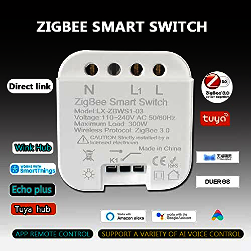

Zigbee hub again not really got for lights, but less than £30, can't remember off hand.
The relay around £14 it was used rather than smart bulbs as it allows used of wall switches as well as using the app.
In my case it is mounted inside the light, in hind sight an error, as can't easy get to it, would have been better in a box in the loft. Centre bulb is a smart bulb in it's own right, so do not need to relay for centre bulb, wife got a pair, no idea of cost.
