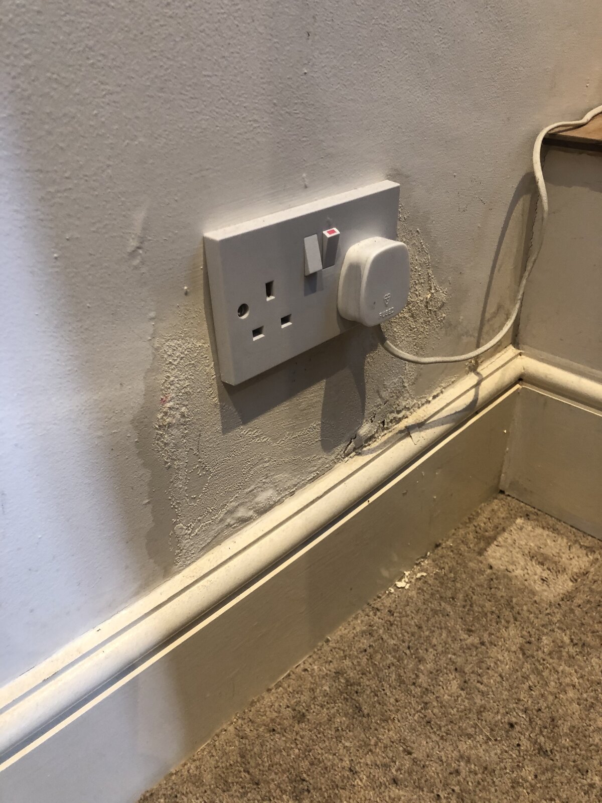

At the start of this year (Feb) I started to have damp appear on an internal party wall.
Just outside the wall - directly in line with the party wall is a shared drain. This had been been backing up so I had it inspected by the water company, roots removed and then relined in April.
Over summer, I thought the wall was drying out. The salts on the surface were becoming less and less but then over the last 6 weeks it appears to have come back even worse. I decided to get the water company out to inspect whether the drain had a leak - they've just replaced it all today. They did say there was a crack in the drain and that they repaired this.
I'm not convinced however that the drain will fix the problem entirely as I think the ground outside also needs lowering. So I decided to also get a local damp specialist in to survey the damp.

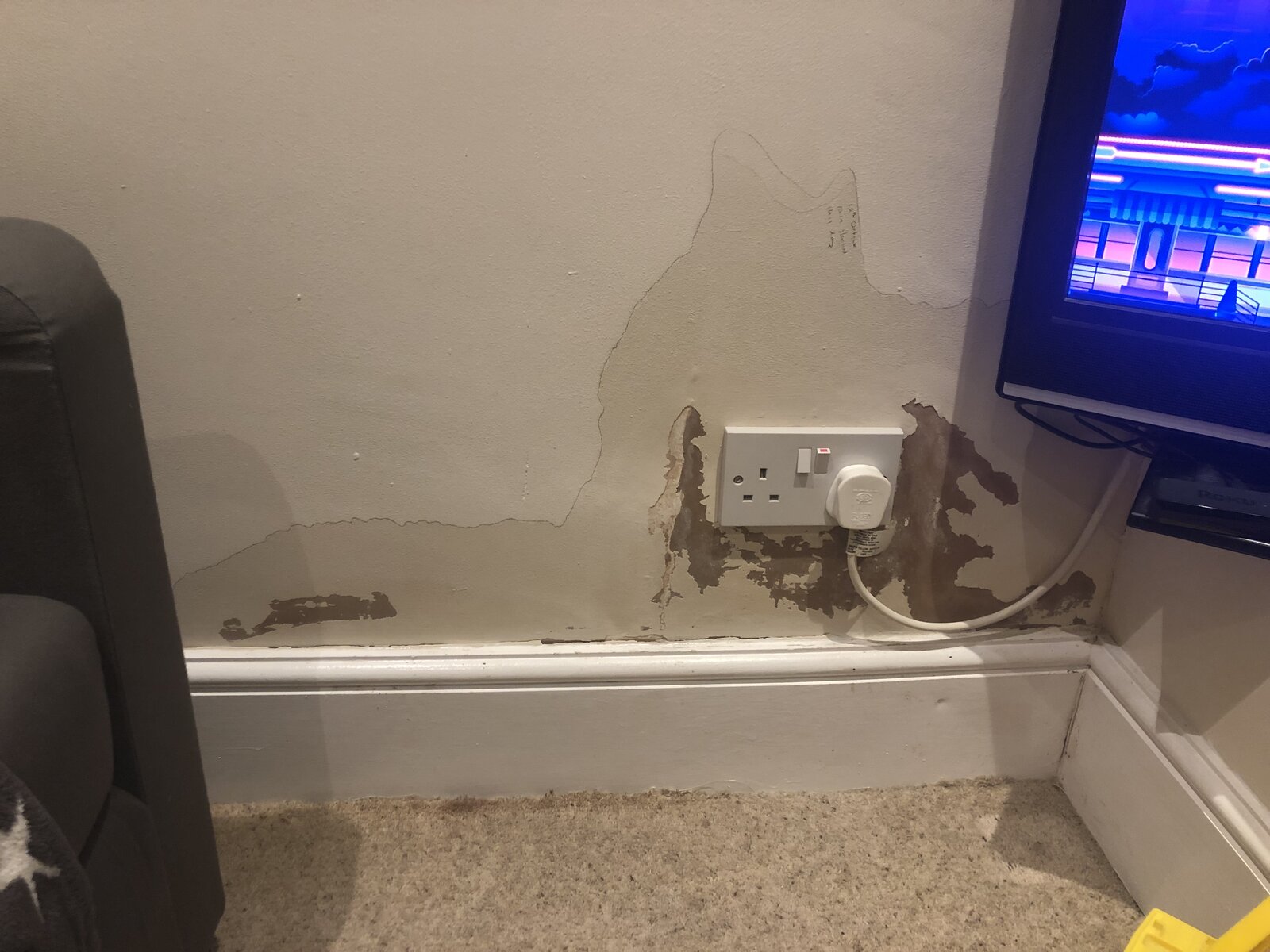

The close up pic (not very good angle) shows the damp when I first noticed it in February, the second pic shows the damp today (I've drawn around the damp patch to see of it changes now that the drain has been replaced)

Any proper surveyor should be able to diagnose the cause of dampness, and any that put a moisture meter (designed for timber) on a masonry wall and exclaim "you have high moisture readings" are not proper surveyors. You appear to have paid salesmen from a firm that sells the treatment that they may recommend. And you have not been given a good service or got anything remotely worth £120 of advice
Anyway, it's clear that that damp is rising. The cause is not so clear, and you don't give enough detail to even make a guess.
But whilst a broken drain may well be causing excess ground moisture, that moisture should not even be getting up the wall. So your problem is "what's wrong with the wall to let water rise up it?"
Blocked cavity? Poor mortar joints or pointing? Plaster touching a concrete floor? The channel/cut out for the electric cable or box? Different wall materials or voids in the wall?
That section of plaster will need to come off and be renewed as its now going to absorb moisture due to the salts. But you need to find out not where water was coming from but why the damp course in the wall may have failed at that location - and fix that. Not just forget about it if the drain was in fact the source of the moisture.

From what I know, the walls don't have a cavity - it was built in 1920 and is cinder block construction with cement render externally. Brick externally at the base (below ground level). There seems to be a bitumen DPC but this is below ground level outside.
I suspect this could be the reason for the damp - but then it's confusing that I have lived here for 7 years but the damp has only emerged in the last 12 months.

It's in the same location Andy - in the right corner of the photo under where the TV is.

The prevalence of dampness is related to the source. Supply leaks = constant and progressively worsening dampness, drains = constantly low levels, waste pipes and rain = irregular.
The old "I never got this before and ive been here 50 years" is based on false admonitions, as every single month let alone year is different in terms of weather and moisture. And ground soils have thresholds which can take years or days to reach.
Obviously ground above a DPC level is a cause of rising damp and needs to be rectified.

start by reducing the ground level outside to below the dpc course.
you want to go down at least 4 " and be around 12" wide
