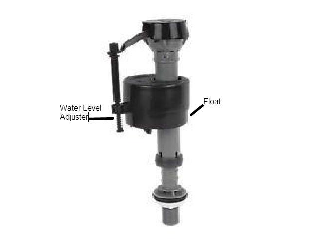

You could have something that looks like this.
This operates the inlet for water, the float is down at flushing, and rises as water fills the cistern, when float gets to the required level, it will close the water inlet valve.
If the float is set to high or come loose, then water will continue to fill cistern, this will then go in to overflow and pan.
So the round black shaped bell is your float.
The black screw like gauge on the left, clips on to float as in picture.
This may have come out of it's housing and require clipping back in position or may need adjusting to a lower level.
It could also be the body of the flush valve has disengaged from it's base, or snapped off a lug etc. Just get a plumber, it's not a dear job. :)
