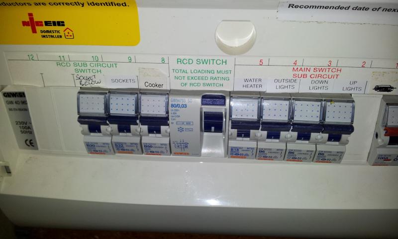

I am looking at putting my new 50in Plasma TV up on the wall and running 2x double sockets behind it. These will be used for the TV, A Router, Sky+ box plus a spare.
The wall I want to put it on currently has a double socket at floor level. This socket is wired direct into a B20MCB in the CU. This is the only socket. All other sockets are on a 32a ring.
Am I right in thinking that I can just run another socket using 2.5mm T&E cable from the existing one and then another from that new one?
Would this create a radial circuit and be safe?
Also, as the MCB is already there with a socket connected, Am I right in thinking I dont need to notify?

If it is a radial final circuit then you could do as you plan.
Just ensure that the new sockets run in the safe zone - if you don't know what that is look it up in wiki.
I assume the existing socket circuit is already protected by an RCD.
If the circuit is protected by 20A MCB and this is the only power point on the circuit, it can be extended and you can installed a number of sockets.
Providing the room where the extended circuit is, is not in the bathroom, shower room or kitchen. It is unlikely to need notification. It will require 30mA RCD protection though.
As far as safety is concerned, that will be a matter of the method, route that the cable is installed and if the test results are satisfactory.

Its in lounge. The CU has RCD in it. Will this protect all?
Providing the circuit is protected by the RCD, some boards are split and don,t protect all circuits.
Easy way to find out, is press test button on the RCD and see if the socket outlet in question, goes from being live to dead!

The Rcd covers the mcb. Did the test button as suggested and the power to the socket was dead. Thats good.
I just wanted to make sure the RCD is suitable as im not sure from looking at it. It has nothing about 30a on it? Have added image.
[/img]
On the photo it has 80/ 0.03 the 0.03 is 30 mA.
Good to go.
