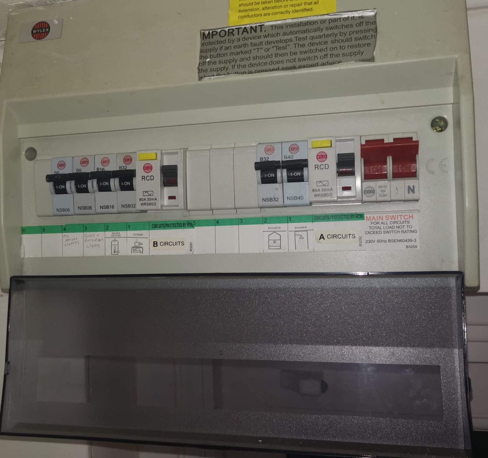

From the looks of it it's a radial circuit. My reasoning for this is that every socket i took off had no 2 or 3 sets of twin and earth but only a single set. The consumer unit has very specific switches too such as "shower" or "cooker" or "water heater" .
We tested some parts last night and it seems that the sockets are all hooked up to one switch in the consumer unit.
I turned off the power and opened a few sockets to peak at what we are dealing with and ... they are all single wired sockets, i looked at 3 in the kitchen.
As one switch in the consumer unit deals with all the sockets upstairs and down stairs and the 3 sockets i inspected in the kitchen all had a single twin and earth connected, would this mean that there are terminal junction boxes all up in the ceiling to split the radial?
The living room has 4x double sockets with no fuse or isolator, she got someone in to do this work so it's a chance that it was done badly maybe?

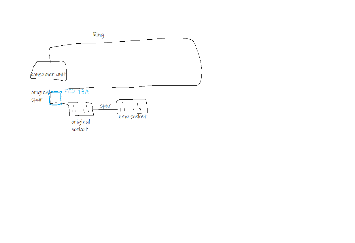

My plan is to feed the wire from one of the single twin and earth in the kitchen in to the wall and add a fused connection unit on to the wall, then spur from that to 2 new sockets.
Does this sound like a good SAFE idea? 2.5mm is up to 26A(27A i read in other places) so if i fuse this with a 20A connection unit i think it should be safe.

The circuit has a 32A MCB so -
it could be a ring or a radial - very likely a ring though.
Is it possible that the sockets you have inspected all happen to be spurs and other sockets will have two or three cables (six or nine wires) attached to them?
No. There would be no difference in what you have seen whether ring or radial.
You would need to place the FCU before the existing socket.
13A is the highest fuse you can put in an FCU. As you say 20A (or 25A) would do but not available.

Would the safest approach here to put a FCU before the original cable assuming that it is a ring under the floor upstairs and that it's spured.
I think regardless of if its radial or a spur from a ring this approach would result in still a safe socket that could not be overloaded without the FCU popping first thus stopping any overload on the 2.5mm before it ? If i'm correct?

The simplest solution may have been to simply fit a 25amp breaker at the consumer unit
but
of course
Wylex do not make 25amp breakers.
not so helpful my friend but i understand the context and message behind it ;) hence why i've done nothing and i'm asking a lot of questions first :)
I'm risk assessing the work before carrying out anything and if it turns out to be a complete nightmare i will get a professional in to carry out the job :)
Ah lovely ok thanks! would i move the breakers along one (ref: my first uploaded pic) and then put this behind it? never wired a consumer unit ever! if this stuff just push on and clip ?
