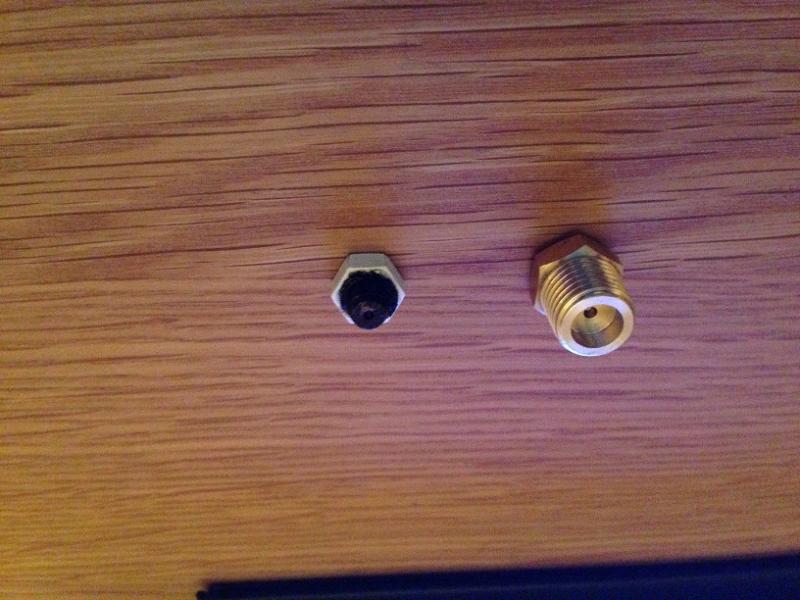

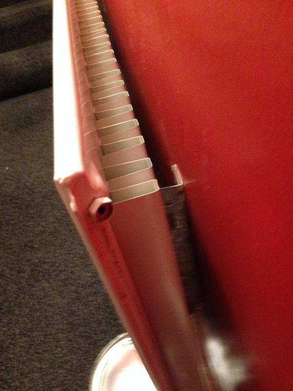

I need to replace several radiator air vents because the nipple has broke off in place.
I've found that most suppliers offer a standard size radiator air vent, which is too big for my radiators (fits a 14mm socket rather than 11mm socket)
The system was installed in 2007, and I have little knowledge of CH so I'm wondering if there is now a standard air vent size for modern radiators.
I want to check if there is a way of obtaining the size of air vent I need before I consider replacing the radiators
ok thanks, looking at the existing air vents they are really small, if I measure the threads they would appear to be 1/16" and the smallest available that I can find on the net is 1/8"

This is the radiator with the air vent in place, without the nipple which in this case is fully removed.
This is the air vent next to a 1/4" air vent.
The 1/4" air vent appears readily available from suppliers, as does 1/2", but all my radiators take the much smaller air vent pictured here
Send the pic to Myson radiators and they'll probably send you a couple with compliments
Thanks for the advice, Myson did indeed send me 4 air vents, very kind of them to do so.
I still don't know what I would ask for if I ever needed to buy them, I guess that they arent a BSP size, they are smaller than 1/8" which seem to be the smallest that are readily available.
Myson are really helpful, they will send a handful out but also sell trade bags of 20
