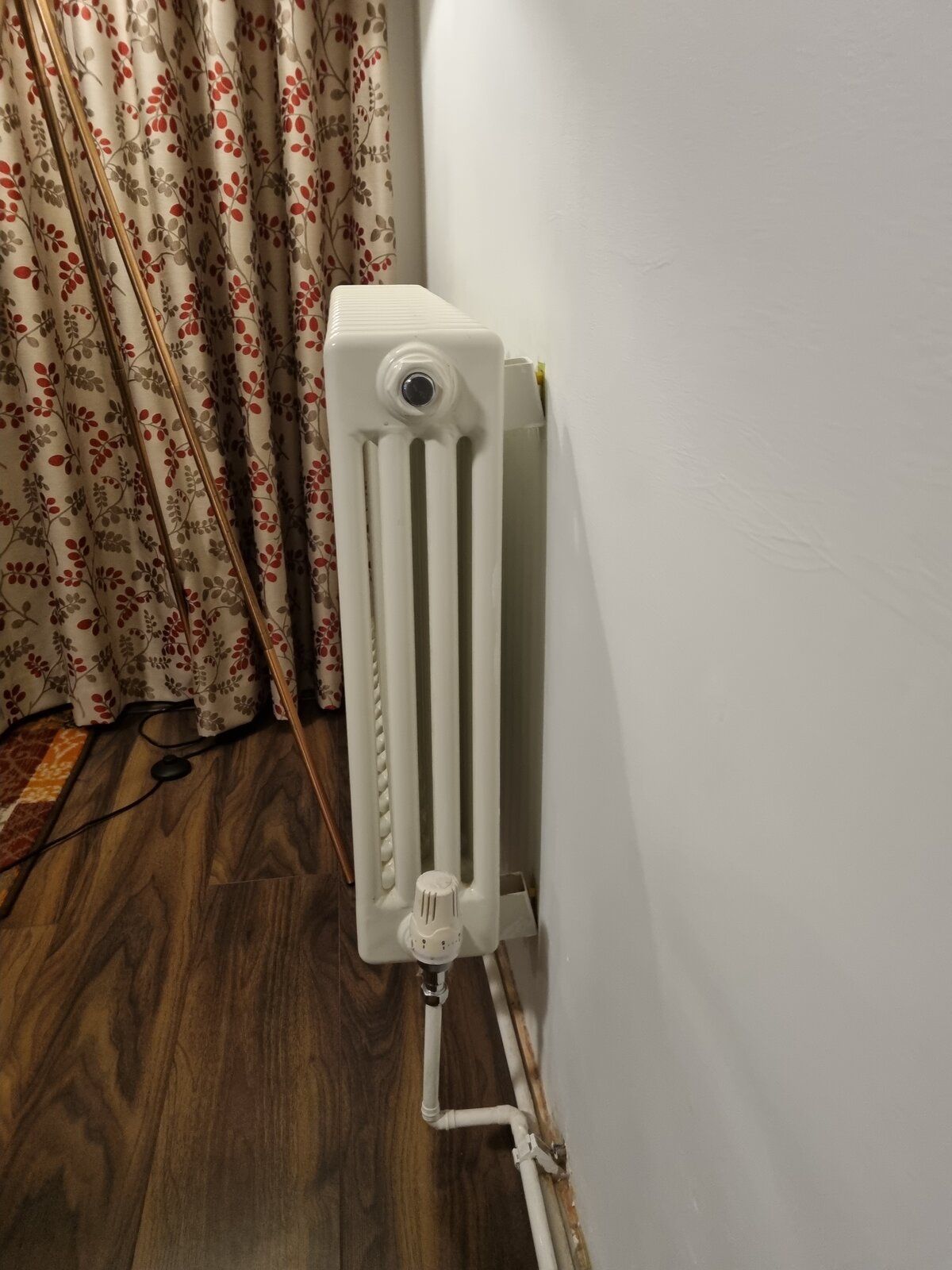

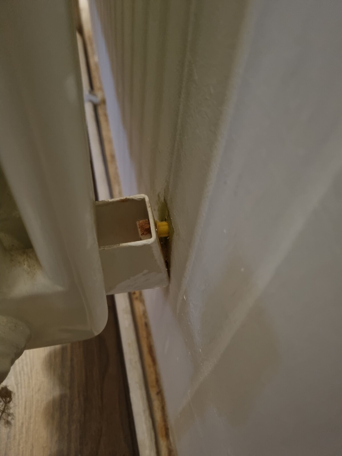

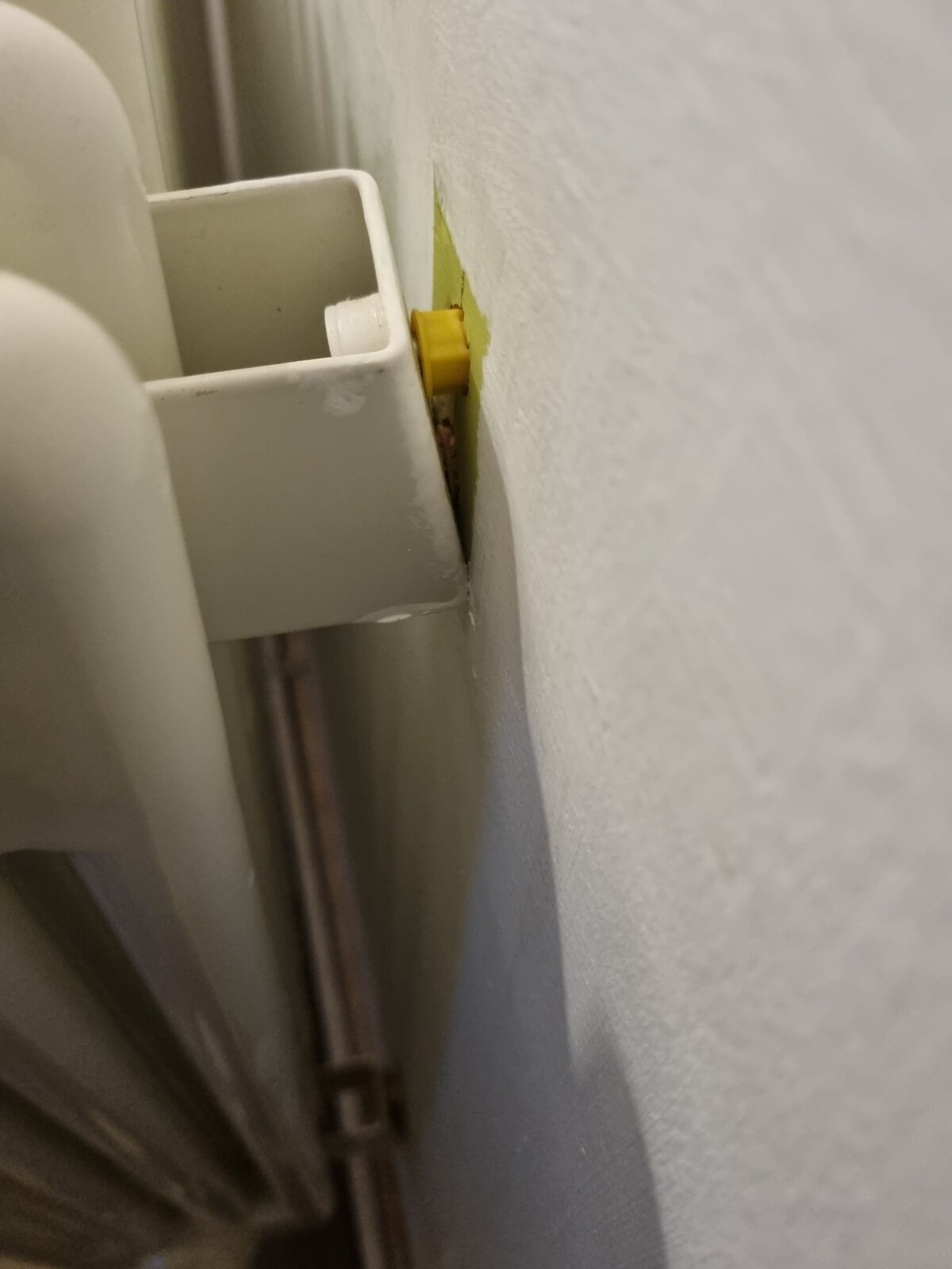

Hi - very new to the thread and very new to DIY...i had my column radiators fitted in 2018. Last few months i have noticed them brackets getting loose of the wall. I called the chao who fixed them and he said its fine it wont fall...but wife and i have our doubts. Attaching pics if anyone could advise how serious is it.

Looks like quite a heavy radiator, and no feet on the bottom to support the weight. I think you should engage a professional plumber to re fit it ,as soon as is practicable. Can you show pics of the full rad

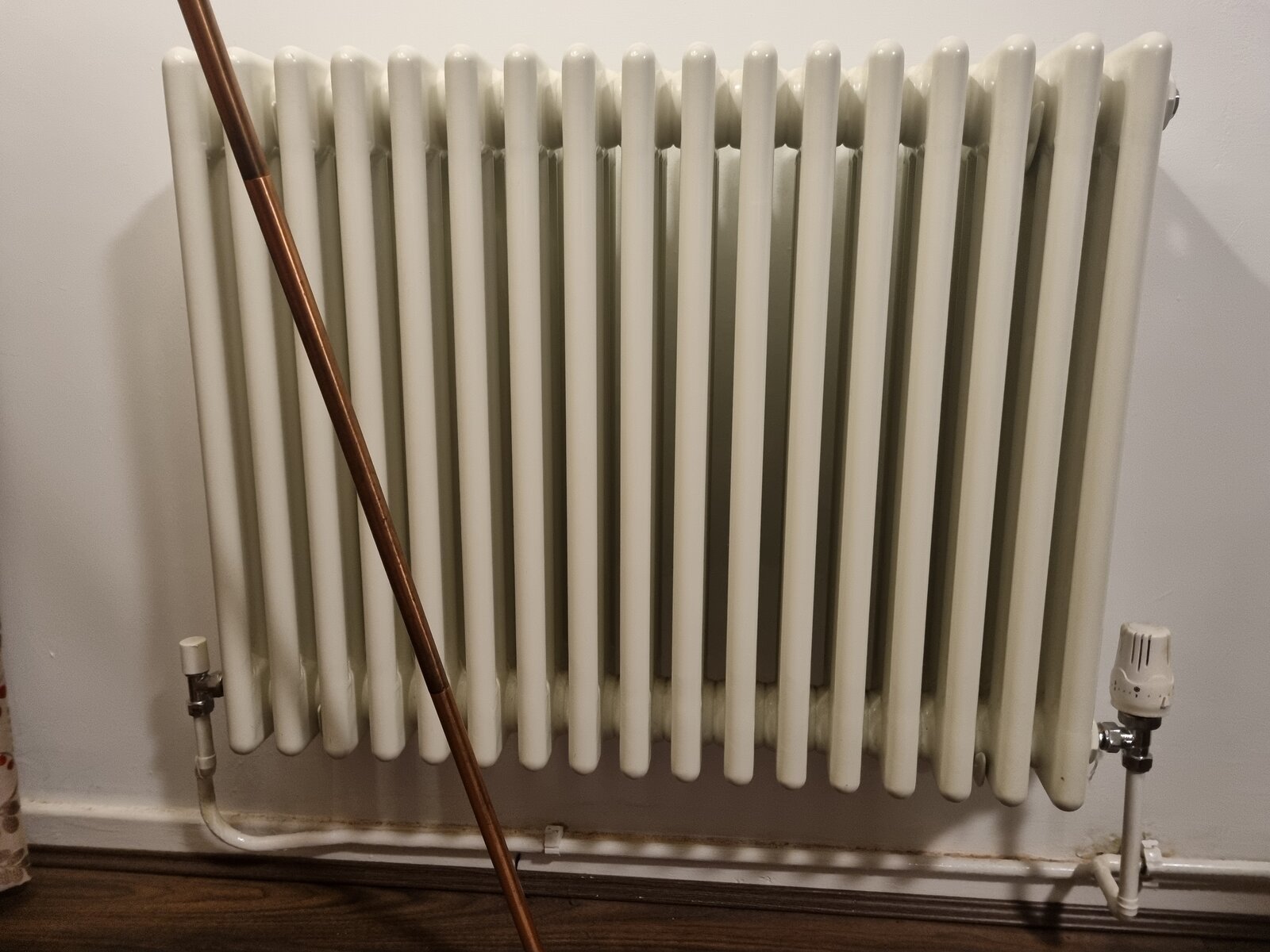

Thanks terry attaching p
pics of the full radiator
Thanks ,its not as tall as I thought. Nevertheless the brackets need to be secured ,and probably best left to a pro.

If you have anything reasonably heavy to put at the front of it, like a hard suitcase filled with stuff or a solid box that can be wedged underneath it, just to give a little extra support until it can be secured properly.
Looks like it might be a plasterboard wall? If it is then the installer should never have used just wall plugs to secure that, it should have had specific plasterboard anchors.
Thank you for your input madrab have some bricks that might just about fit to give it that support..thank you once again for your advice ..much appreciated
If you gently/carefully support the rad back onto the wall and then tease the bricks underneath, use a cloth or some thick card to stop them scraping the rad paint.
