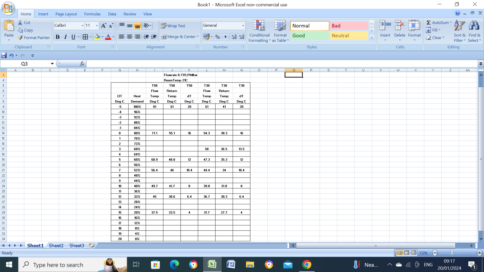

I did these calcs for someone whose present rads require a flow temp of 81C to give a room temp of 21C at a OT of -5C. and intended to install a condensing boiler with WC and intended to install new rads downstairs based on a "T30 rad" (double the size of the existing rads).
It can be seen below that even doubling the rad sizes will only give a output of 68% at 50C so if 100% output is required at -5C, the rad would/will have to be oversized by a factor of ~ 2.9, almost X a factor of 3 or as stated above, install 2 rads, a bit messy, its easy to see why UFH is, by far, the preferred choice for new installs.
