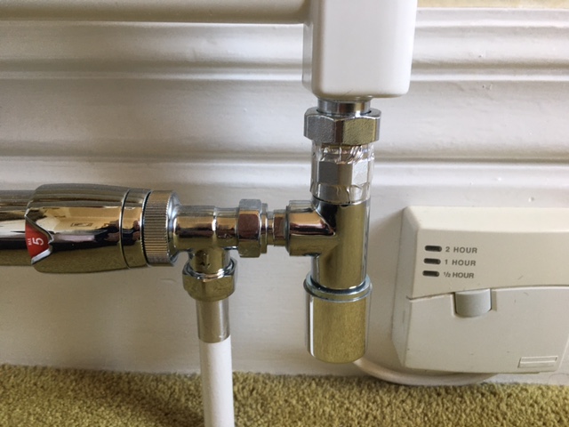

Hi everyone. I'm fitting a CH towel rail, with an elbow angle adapter to take an electric element as well as the water. There's no taper on the thread, so the adapter screws in until the thread ends. At that point, the pipe connection is pointing out into the room, which is no good of course. So, I've used a lot of PTFE tape and left it not actually tight. It wound in with a smooth resistance, but now as I fit the pipework it does swivel, if I push.
What do you think? Will it seal like this under 1.5 bar of pressure, or is it doomed and I need to find a better way? Any expert advice would be greatly appreciated!
You may not have put enough turns of PTFE on the threads ,it should feel a little tight when screwing the fitting in ,rather than " smooth resistance" as you put it.
A smear of LSX on the thread should ensure its leak free.
Thanks Terry. I have some LSX so I'll dismantle and add some of that and more PTFE. Appreciated :)
I've just gone through a similar exercise fitting a heater-T to a new towel rail. Despite internet searches I could not find a tecnically sound engineering solution. What I ended up doing was to get hold of a cheap stop valve such as shown. The valve was throw away but the taperd end complete with nut (let's call it the tail-piece) was fitted to the radiator. Then, in brass, I turned up an interface piece which connected to the mating face of the tail-piece on one end and had a 1/2BSP paralled male thread on the other end to connect to the T. The combination of the tail-piece and the interface unit permitted the T-piece to be orientated to suit my plumbing without the use of PTFE tape. Attached is a photo of the unit once fitted with some aluminium tape wrapped around to give a semblence of chrome.
Sealing of the taper on the tail-pice to the radiator is achieved by smearing Atmos-Pate onto the threads before mating. Similarly sealing the thermostatic valve attachment spigot fitted to the T pice was also achieved using Atmos-Pate. I have used this product on numerous taper installations, never had a failure and once it has set (give it 24hours) it will not come loose in normal operation. It's rated up to 100degC and is intended as a porcelain repair medium !
Sealing on either end of the interface piece is accomplished via the in-built 0-rings on both T and tail-piece. The heating element also had it's own sealing o-ring
Of course the plumbing purists will condem it as a "botch-up" but unless they can come up with a properly engineered alternative then my properly engineered solution is, in my chartered engineering eyes at least, perfect.
If it doesn't already exist the design is copyright to me. © 2022

Thanks so much Jackrae for that comprehensive solution. The adapter is not properly engineered is it! I'll have a look through my box of bits, check out Atmos-Pate and see if I can infringe your copyright :mrgreen:. If not I'll give the LSX a go and hold this in reserve as the ultimate solution. At least I can drain the towel rail on its own, if I need Plan B.
