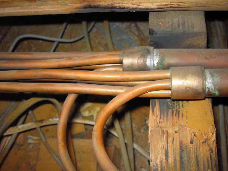

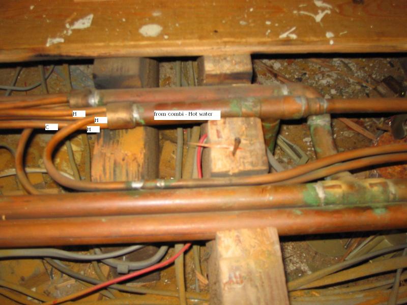

I have found two pipes coming from the manifolds which I could potentially use for the radiator.
However at the inflow manifold I have four pipes coming out and when the CH is switched on only three get hot. The fourth is one of these pipes that I discovered.
The other manifold is obviously the return flow and one of the discovered pipes terminates here

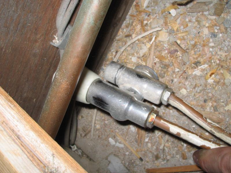

At the other end of these pipes is a valve.
How come one of them is not getting hot when I turn on the CH, after all it is coming out the same manifold, or do I need to turn the valve on or something??
does this make sense? to simplify
there has obviously been a rad in the bathroom at some stage but now it seems the pipes are locked off in a valve.
if I remove the valve and terminate the pipes at a radiator should all be ok????
Can't see any reason why not. Make sure you use a bi-directional TRV on the bathroom rad if you cannot determine which pipe is flow or return.
