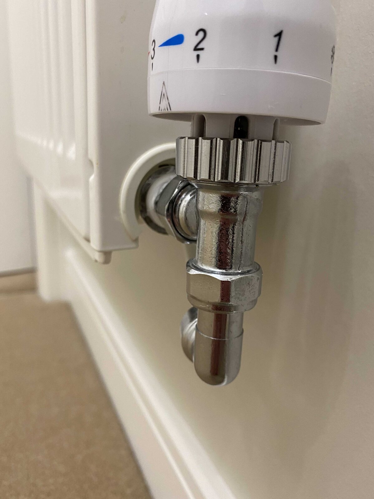

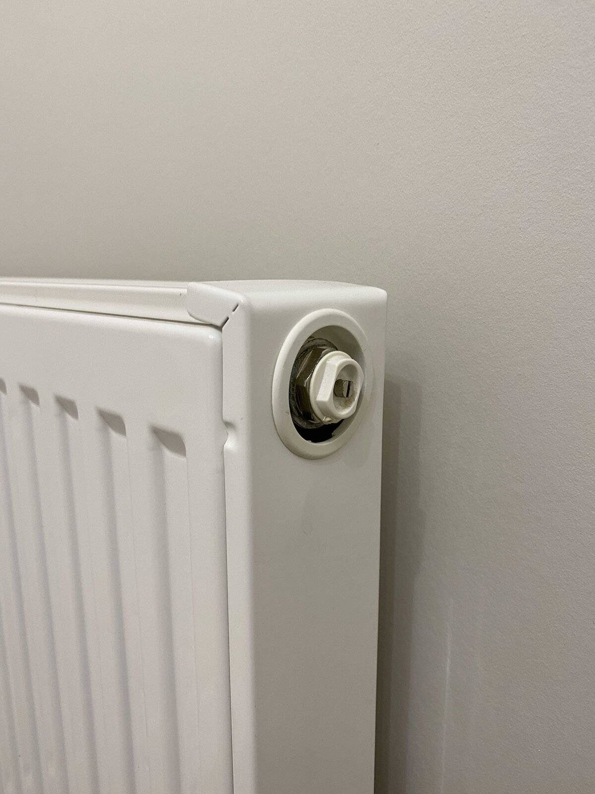

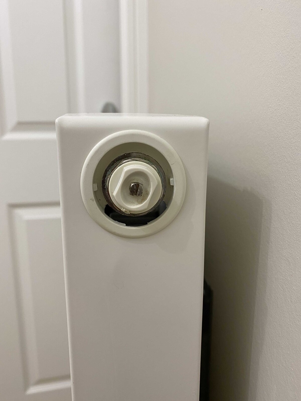

I've been trying to avoid asking this question because it seems stupid but, I can't work out how these side panels come off so that I can clean the convector fins of dust.
The plastic collar around the bleed valve turns but it seems to lock onto metal behind. I can get the bottom off without issue.
You can lift the side panel up, but it hits the bleed valve before the collar disengages from the metal.
Is there a way to take them off without destroying the plastic collar or removing the bleed valve?

Managed to sort this. I lifted the side panels up as far as they go then the top grille slides to one side exposing one end then you can just pull the grille up.
The sides aren’t meant to come off without taking out the bleed valve/blank. S*** design!
Yes they are, they may just need a little bit of extra pulling.
If you are cleaning the rad of dust then just use a hoover hose and pipe and run it under the bottom of the rad, that's usually where it all collects.
