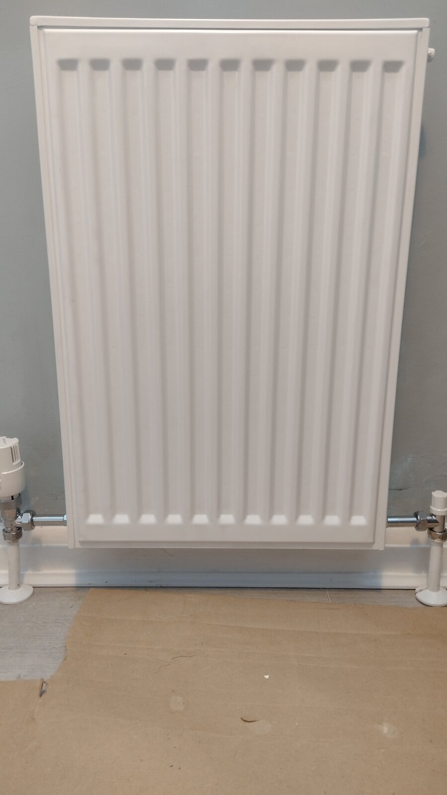

Hi we have just had our radiators replaced and I am sure that the plumber has fitted a rad that is too small, when we measured up (imperial) we thought we could get a 500 in, but he has fitted a 400 with spacers. I questioned this but he said that's all that can fit, how do I check??
Thanks, just measured it and it's slightly to small, problem is the rad is showing to be too small for the room with the BTU calculator??

no 500mm is metric 500 " imperial would be a massive rad
As above, measure between the valves. Looks to me like there's room for a 500 there, plumber probably had that one left from another job :) .
That was my thought too. If the old one was 20" = 508mm, so a 500mm rad should go in nicely. Difference taken up by play in the pipework, and how far in the rad tails are screwed.
