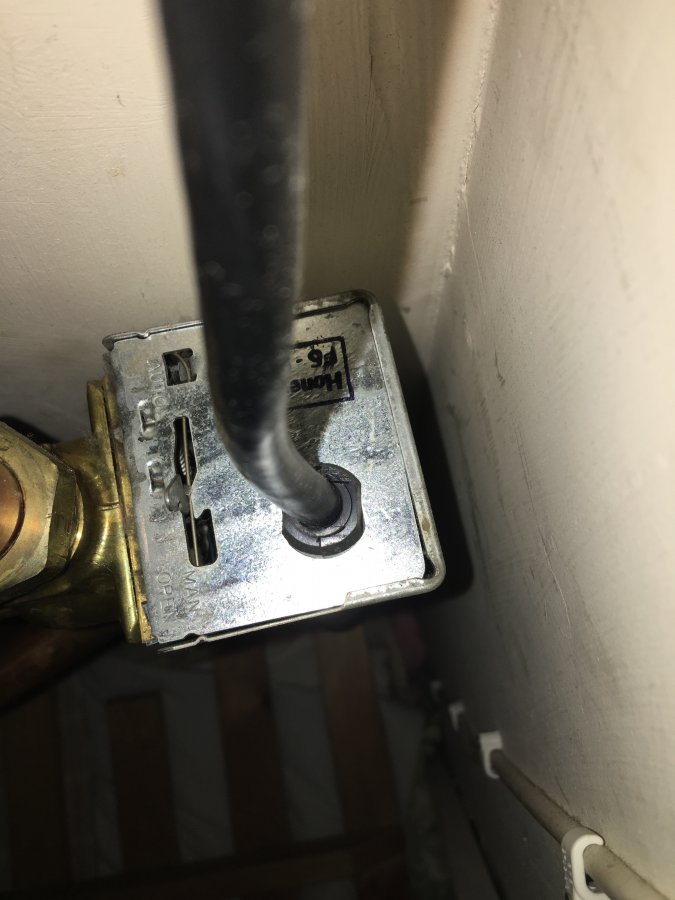

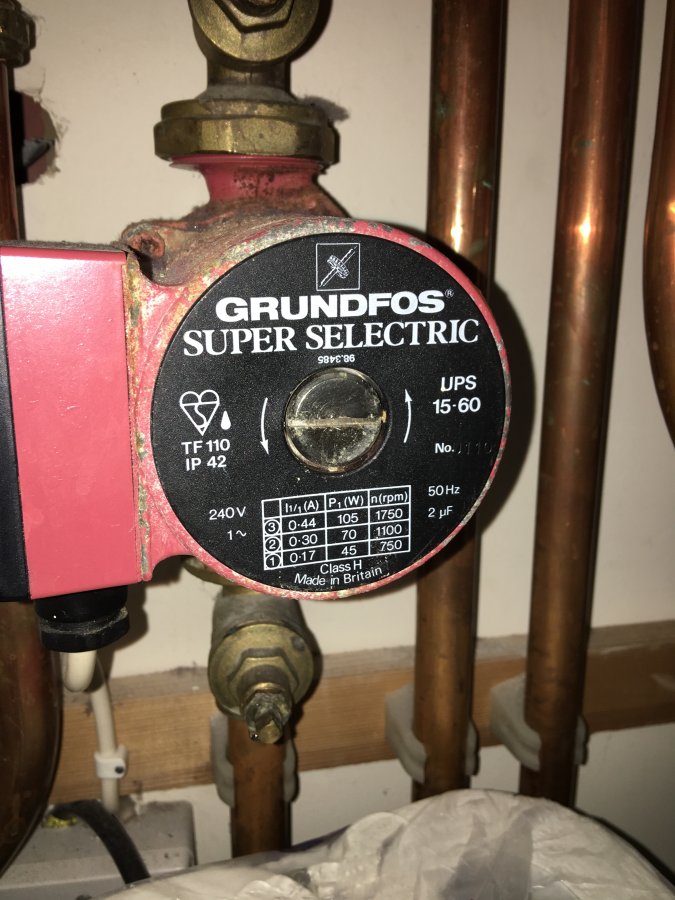

Hi there, slight issue with my central heating system. When I switch to hot water to heat the cylinder the upstairs radiators get hot, tried turning the rads off but then the downstairs ones get hot!
I've opened the valve and turned it manually and all seems fine, as well as the valve I have a switch which I suspect may be the issue, these are photos:
https://flic.kr/p/JS4BVD and https://flic.kr/p/JS4C1Z
Appreciate any help anybody can offer.

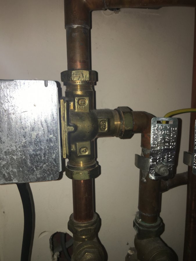

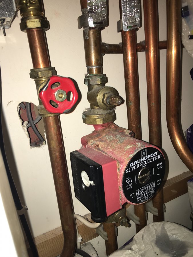

Does that valve have 3pipes coming off it or 2? Probably the valve passing.
Just the two pipes, pic attached. Thanks

Ah apologies yes, that has 3 pipes, pic attached. Not sure if you could make it out on the original pic but that 3 port valve switch is stuck in the middle, either side it has auto or manual but it's in the middle at present.
Yes it's worked fine since we moved in 8 years ago but this summer turn the water on and the rads get hot too

Strange thing is, this morning I took the pic of the 3port valve and the switch was central, tonight the switch had moved to auto, put water heating on and once again radiators got warm...switch is still set on auto
