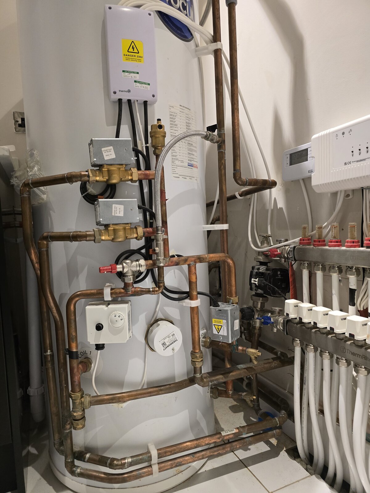

My radiators get hot when the hot water is switched on . I have checked other valves for the radiators and UFH. They are both closed. Only the hot water valve is open. I also tested with just the heating on . The hot water valve closes.
I touched all the pipes to feel the heat I noticed that the hot water outlet pipe was hot to touch which is as expected .
I also have a pipe which is a run from an outlet labeled coil 2. I presume this is the boiler return outlet . This was also hot to touch .
Below is the picture of the set up. What could be causing this?
The failure of the valve within the brass body of the mv?
recent fault then the valve is passing
