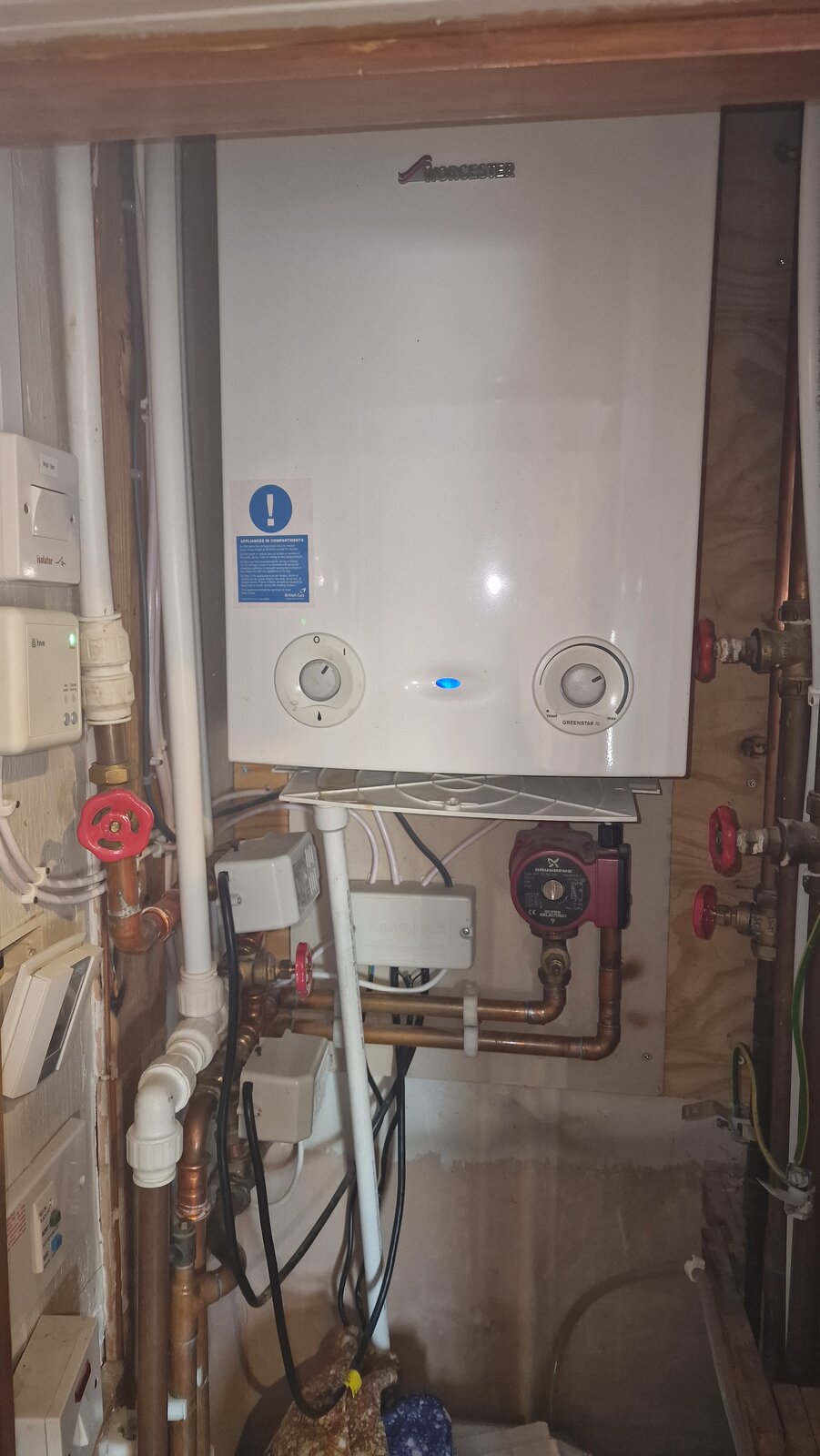

I'll get some pics shortly.

How many rads ? and good photos of your boiler and piping arrangement would help us to give some ideas.

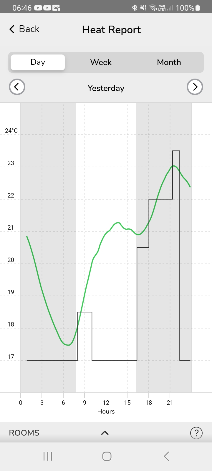

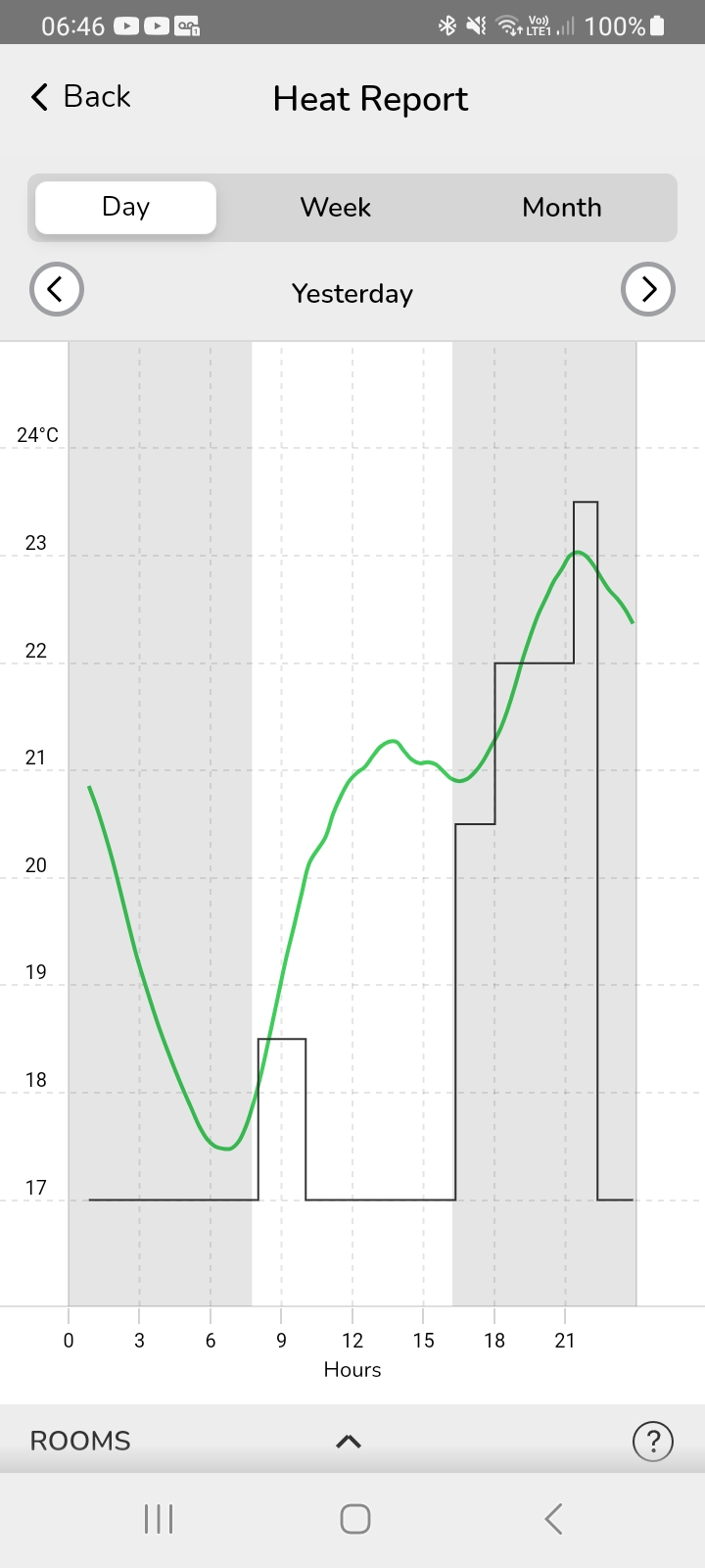

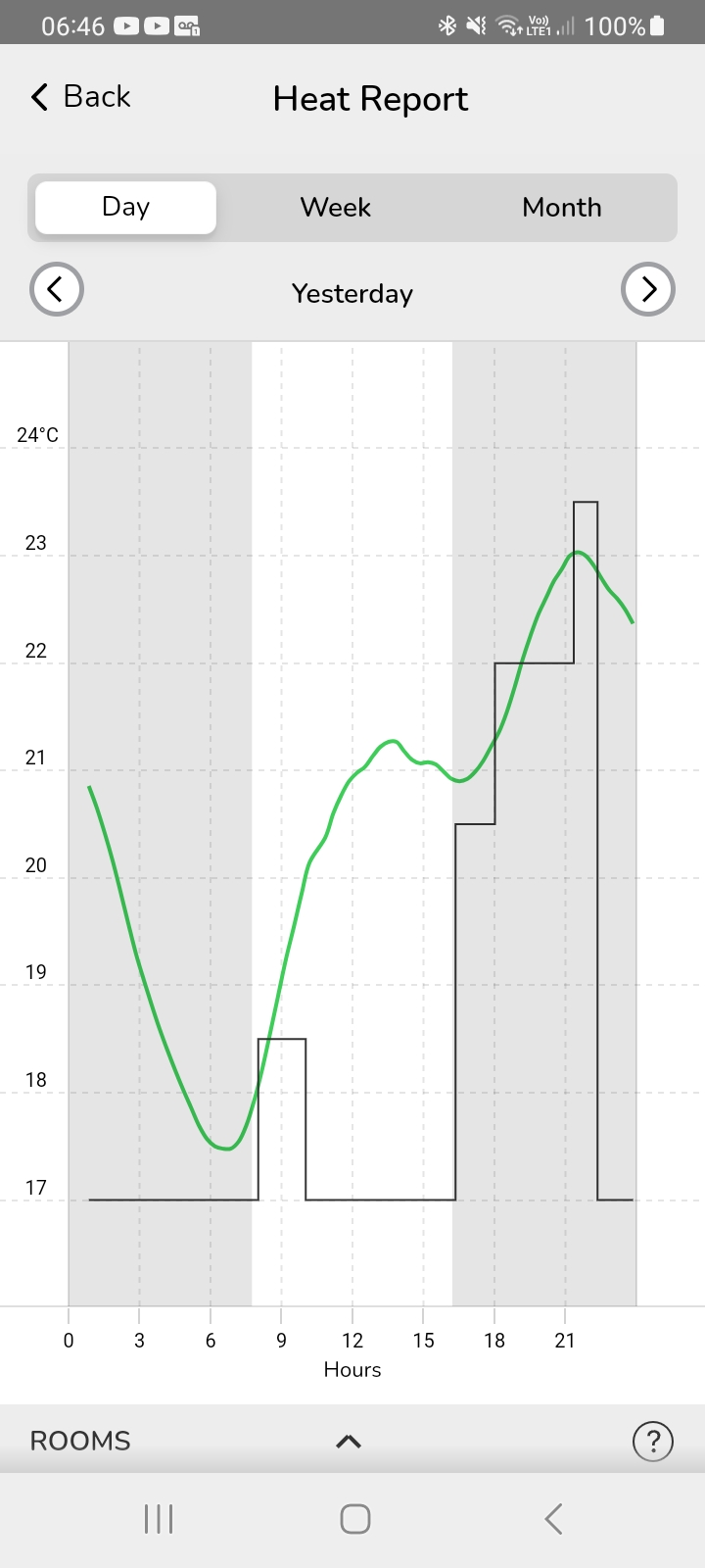

Any other thoughts after seeing the pics? My hive app just shows that the UFH and Rads are pretty much on all the time trying to get the rooms to 18 degrees. The Rads are not even working it seems as the UFH is taking everything. I think everything in the boiler cupboard is new except the boiler and pump. My hope is that whilst a new more powerful pump might not completely resolve the issue, it might just force the hot water around everything better????

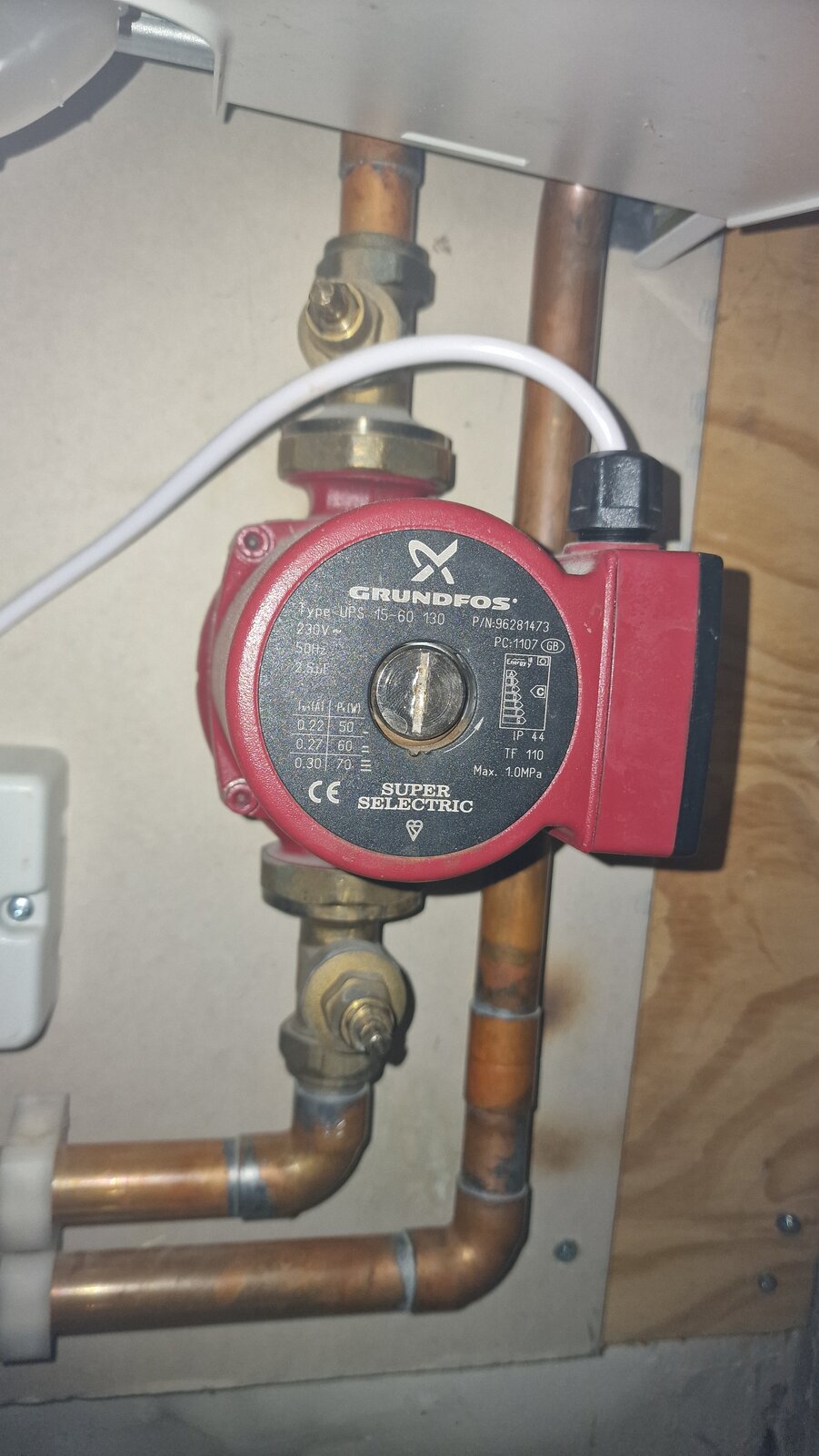

While those Selectric pumps were very long lived, the 70W wouldnt be that powerful, you could isolate it, remove the pump head and ensure/cleanout the impeller vanes with a tiewrap. Will have a look at pumpcurves later.
Thats a vetern pump....PC1107, built in week 7 2011.

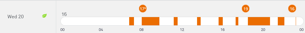

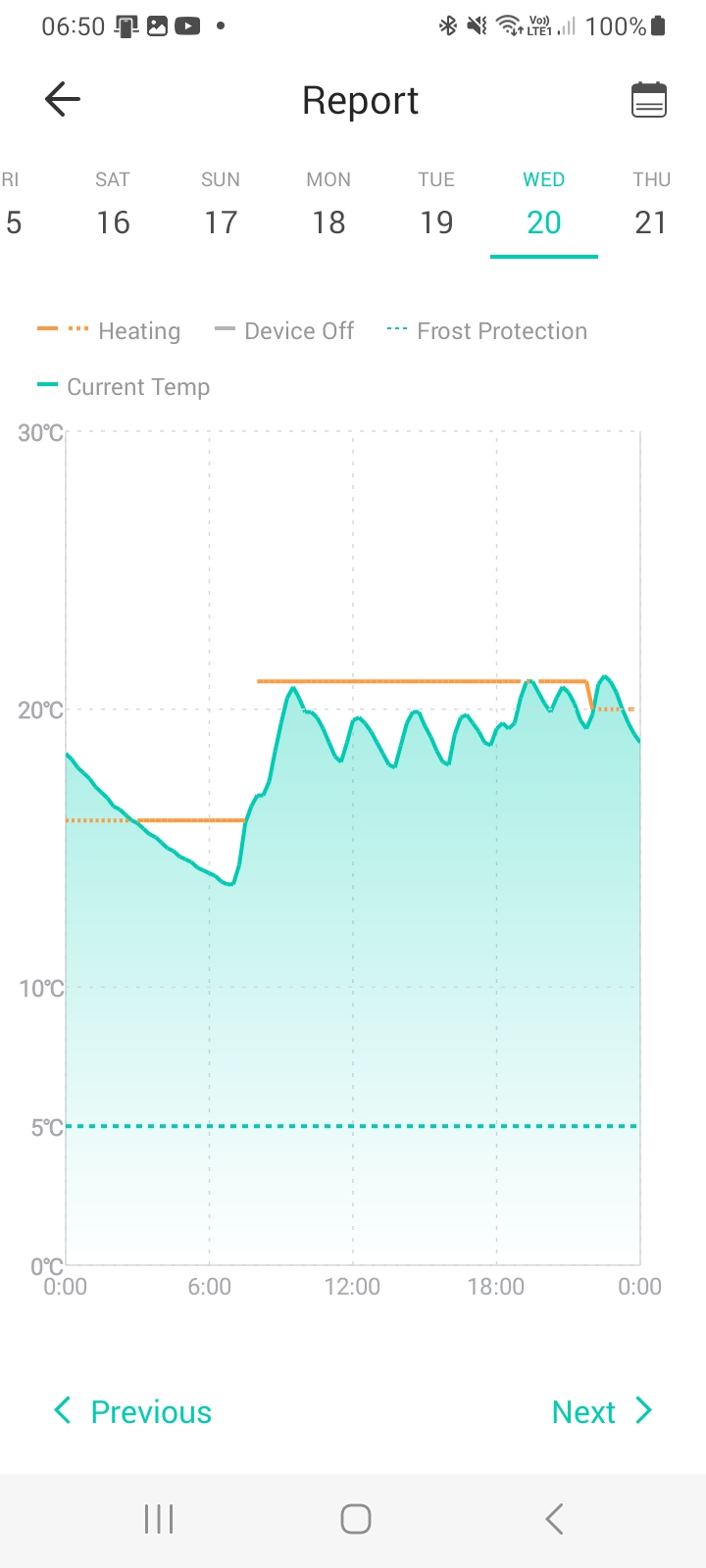

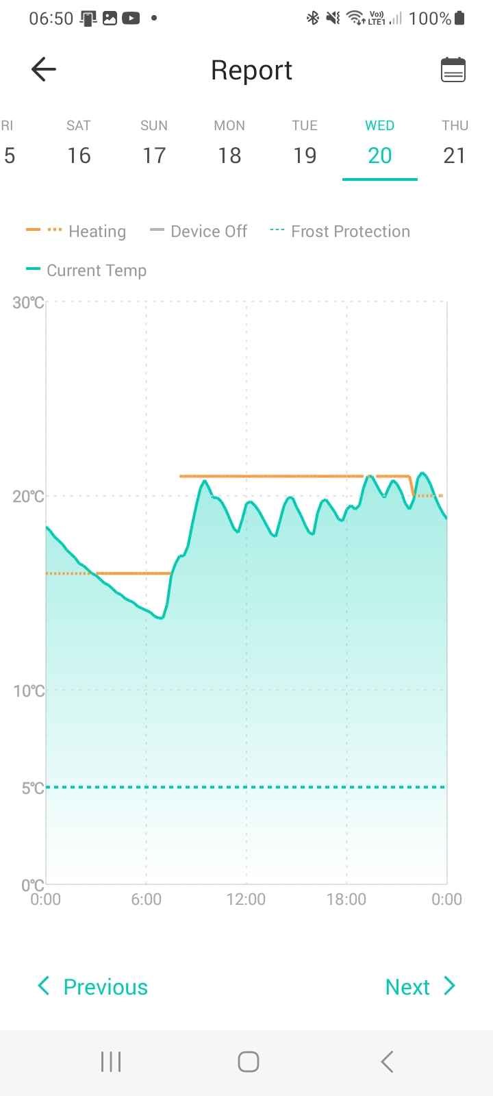

I may be completely wrong here, but I had a problem, which was caused because the boiler did not run for long enough. Yesterday
The 8 am burn was long enough, as was the one when raised temperature to 19ºC, but the other burns would only heat a couple of radiators fully, as simply not running long enough to reach all the radiators.

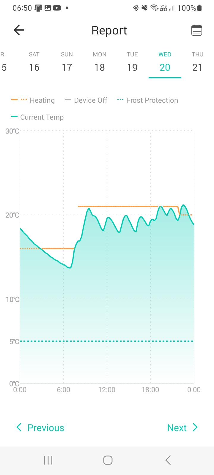

In real terms the display shown is a back-up, I also have a second thermostat that now keeps the boiler running for longer, 1732171647947.jpeg the second thermostat only shows room temperature and temperature settings, not when it run the boiler, but real control of the room is with the TRV heads. 1732171874559.jpeg which also report how they have done, which seems reasonably good, and we were comfortable in that room yesterday, but it does not matter what the TRV does if boiler not running, or what the boiler does if the TRV is closed.
Ideal is to have the TRV control the boiler, so boiler runs when required, but as yet not done that, idea is as TRV's close, it will force water through those still open, so there may be a delay with some rooms heating, but they all will heat up, but of course only if the boiler is running.
I see you use Hive, I believe Hive will only accept a demand for heat, if the wall thermostat is below 22ºC so having the room with wall type thermostat set too high could stop other rooms heating up.
From the photos I would be looking at reconfiguring the boiler cupboard with either low loss header or close couple tee set up , only my opinion
