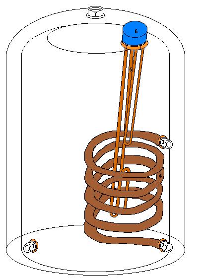

The immersion heater is completely different. The immersion has an electrical heating element (shown with blue top below) and is not connected to the boiler/radiator system at all. The coil of pipe shown at the bottom is what is heated by the boiler.

Yes sorry I was referring to the Danfoss dial at the bottom of the tank that connects to the valve. Presumably the higher this is set the longer it will take for the valve to switch over to rads only? Sorry for being a bit slow on this one, but I'm learning fast!
