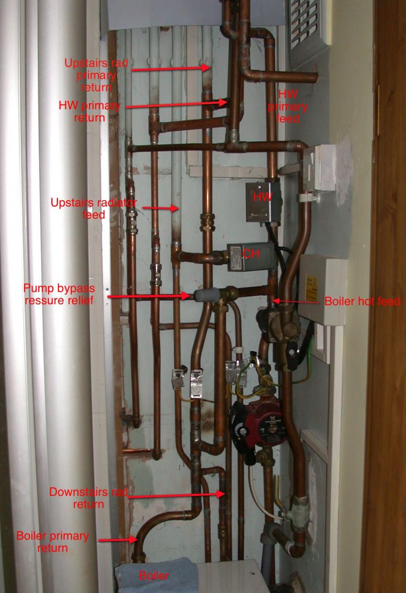

If the hot water motorised zone valve is on, but the central heating motorised valve is Off, the radiators still get a little warm.
The attached photo of the pipe work above the boiler shows the layout
[/img]

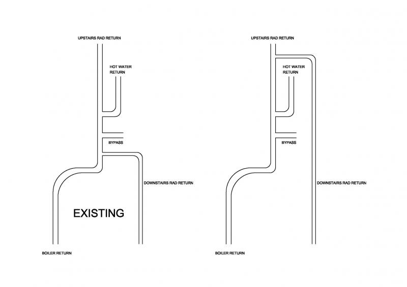

Look more like reverse circulation.
you got 2 rad returns to the primary return.
Keep all your posts together makes it easier you have started a few posts for the same fault.
It's fairly simple to rectify, both of the radiator returns need to enter the final return to the boiler before the hot water return and bypass.
