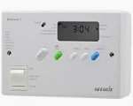

Time switches like this 1728730771726.pngfor the immersion heater have changed over the years, the old switch with two supplies, is now hard to find, the storage radiators tend today to have a trigger wire to turn them on, and often people now have Economy 10 where one gets a boost through the day.

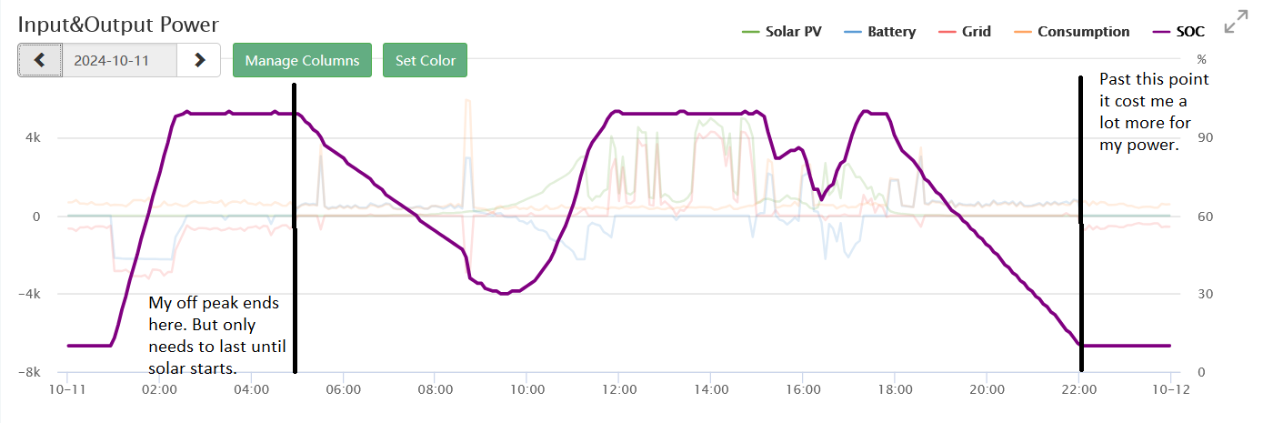

So for me 1728731697460.png I know when my home starts to use peak power, between 4 pm and never depending on sun light, but not so easy for you, to store energy in a battery means it does not leak, but expensive to store, to store in iron ore bricks, bound with clay or cement, you in most cases can't stop the energy escaping, there were some homes with central storage, and fans to blow it around when required, i.e. true central heating, but most used silly storage radiators, which leaked energy out even when turned to lowest output.
So the problem is for most people they only want a back ground heat 11 pm to 6 pm and the storage radiators has run out just about when you want the heat at 6 pm, assuming sleeping at night and at work during the day. So even when off peak is 8.95p and peak 31.31p per kWh the 29.57p per kWh 24/7 can work out cheaper with panel heaters due to losses during the day.
But it is mainly down to how well the home is insulated, there are two methods of heating the home, one is maintain the home 24/7 at a set temperature, the other is to look for fast recovery times. What you need to do is work out once the 7 hours are where they should be, will it keep your home warm?
