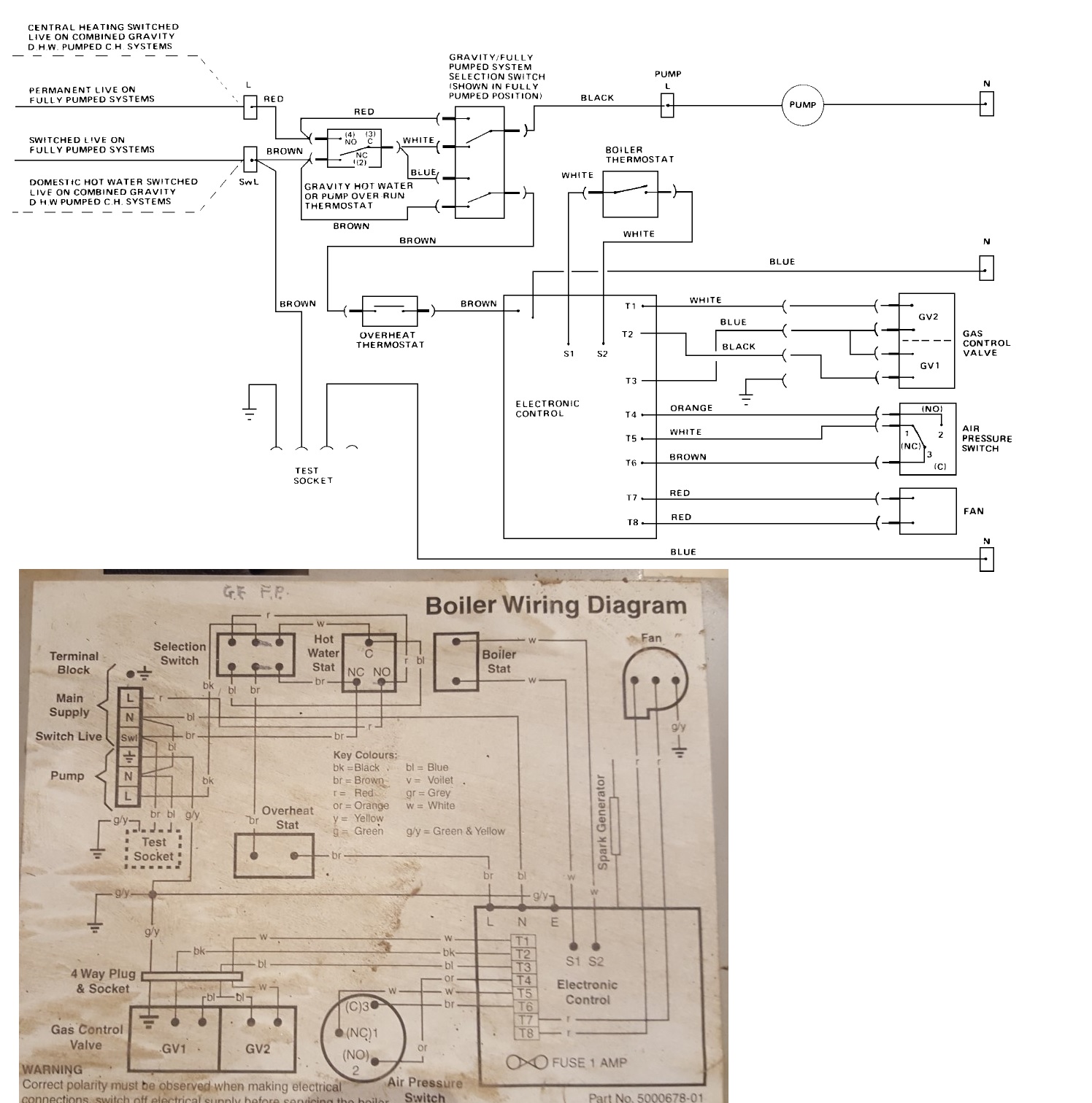

We have an old Potterton Profile 80e.
Now that the cold nights have started, I've just set the programmer to run the CH.
I've just noticed that the CH pump stops when the boiler cycles to off. Rads take forever to warm up!
The selector switch in the boiler is set to Fully Pumped, so the pump should run all the time the CH is set to be on.
When the boiler cycles on, the pump runs.
The manual shows the selector switch set to Fully Pumped and the pump connected to the Gravity Hot Water or Pump Over Run Thermostat. Maybe this is faulty?
Looking further at the manual, when the selector switch is set to fully pumped, power for the pump comes from a terminal marked switch live, via the Pump Over Run Thermostat. It says that this is for an external control, which I assume might be a wall thermostat, and if there is no external control, this terminal should be connected to a permenant live.
Checking the wiring, the switched live is connected to a the main 4 core cable that heads up to the airing cupboard where the pump, valves and water cylinder are. This is where the main CH system terminal box is too. The switched live wire is present there in the terminal box but it's not connected to anything else. It's just looped to two other terminals marked Boiler and Pump.
So is it possible that the system has never been wired correctly and the rads will only warm up if there is demand on the boiler for hot water or the underfloor heating system?
Any tips on what to check?
Cheers.
(Boiler schematics below)

Yes, after checking the book of words, that boiler has an overrun stat in a dry pocket on the HEX, therefore it will switch off once the vial temp drops below 80DegC and activates the switch.
That should be wired internally and as you say the output from that stat should run to the pump. If the stat has gone faulty then rather than replace the stat the pump may have been short circuited over to the programmer's SL, therefore when the programmer no longer call for heat that SL is de-energised and the power is cut to the pump.
If the pump is connected that way and you then switch that to a permanent live then the pump (and boiler) may run all the time. It needs a little more checking to see where the live feed from the pump runs to, that'll give you an idea of where it's currently connected to.
If you're handy with a multimeter then it would be time to check the overheat stat too, check it for a resettable cut out or adjustment, you will also be able to replace it if it is found to be faulty.
The boiler has a dual function internal 'Gravity Hot Water or Pump Over Run Thermostat'. It is factory set to approx. 80 degrees C with a single changeover contact. In your circuit diagram 'NO' is connected to 'C' when the temperature is under 80C and 'NC' is connected to 'C' when the temperature is over 80C.

I have never changed the switch for Gravity/Fully Pumped, in fact I only found it yesterday when I read that there is one!
I read that the pump over run stat bulb is fitted slightly differently for fully pumped, so I will check and see if I can see that too.
I don't think I will be risking anything by wiring the switched live to permenant live in the terminal box just to see what happens, wil I?
The manual says to do this.

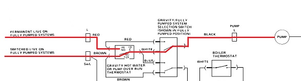

In which case, according to the wiring diagram you supplied; in fully pumped mode the pump will run whenever either the CH or DHW are calling for heat. So whenever the boiler is 'on' the pump will also be 'on'. But It shouldn't physically cycle 'on' and 'off' with the gas burner itself. You can see from the diagram the only places that the pump should get a live from are the externally supplied 'permanent live' and 'switched live'. It's in no way linked to the gas burner.
Under normal 'running' circumstances, there should be a permanent live on the top L terminal, and a switched live present on the bottom L terminal, meaning the pump will receive power as per the diagram below, regardless of the position of the pump overrun thermostat.

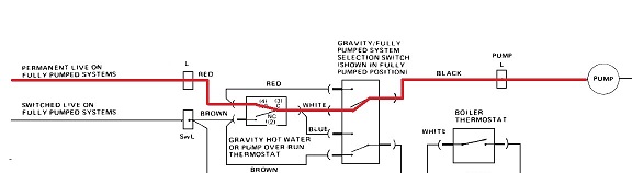

When there is no demand from the external controls, the switched live is removed, but, the pump will run on, provided that two criteria are met:
1. The overrun thermostat is sensing a temperature in excess of 80.C and
2. The permanent live is present on the top L terminal to provide operating power
If either the permanent L isn't present, or the thermostat detects less than 80.C the pump will stop with the boiler. Once the temperature drops below 80.C the overrun thermostat changes position (to NC) and removes power from the pump.
You can see from the above diagram that the permanent live is required to keep the pump running when the switched live has gone. Which means that you won't get a pump overrun if the permanent live is missing.
