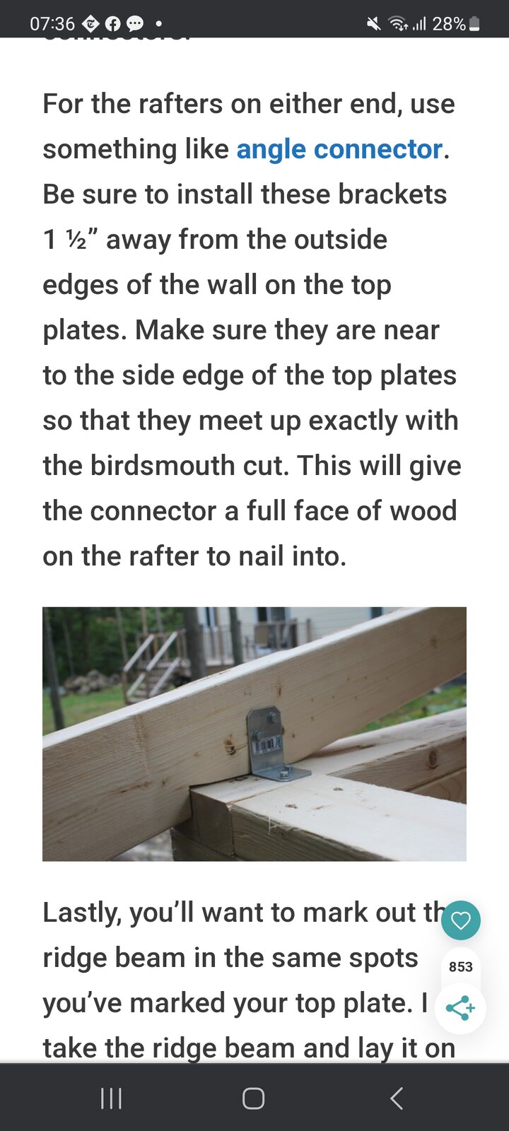

Right so I've just been reading a bit more and for end rafters, some article has stated to just use an angle connector (pasted below).
I'm not using bird mouths to be fair but butting up against the wall plate.
Truss clips for all but the end end rafters, angle bracket and a couple of toe nails?
Strength wise that'd be absolutely fine surely, but I still want to do it *right*
Then your brackets will suffice.
Thank you... And is this with the same truss clips inset from the side or should I be aiming to have the end rafters flush? If flush then angle brackets and toe nailing?
