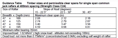

Is it feasible for something like 2x7/2x8 to span 3600mm off the ridge plate on to the wall plate with a vaulted ceiling at this pitch? Tiles will be low pitch pan tiles.

Google rafter span tables and work it out, but I think you’re looking at 6x2 or 7x2 from memory at 400 centres
Struggling to find a span table to match what I'm after. Is it acceptable to work of a c16 flat roof joist table which states 50 x 175mm spans 3.81m on 400mm centres? Assuming this would be similar to a flat roof with a pitch of only 15 degrees
Looks like 7x2 as you’re not that much more than the 6x2 max span at that pitch
Span is measured bearing-to-bearing up slope so your 15° span would be a little longer than 3.81m. I suspect your options would be 50 x 175 C24 @ 400 c/s or 50 x 200 C16 @ 400c/s.
If you wanted to use cheaper 50 x 175 C16, consider bringing them in a little to 350 or 375 centres.
If the cill/roof pitch is a problem, you can take a good 3-4" out at the lower birdsmouth, which might enable you to get another inch or two below the cill.
