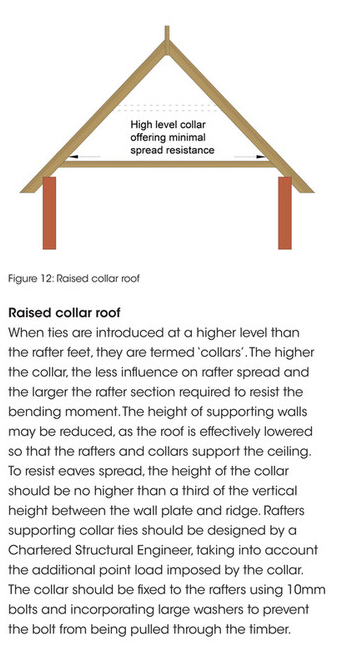

If my dormer roof was a 45 degree pitch, instead of adding rafter ties sitting directly on the wall plate, can I add these ties 1/3 of the way up? Trying to maximise ceiling height.
Dormer will be 3600mm wide, 45 degree pitch and have a ridge beam (as opposed to board). Total height of pitched roof 1800mm.

I've always known these as raised collars
IIRC, the approved docs allow for these ties to be raised up to 1/3 of the height, and after that you'll need to justify by calculation
From LABC warranty
If you have a ridge beam then the ties become redundant in preventing the roof from spreading and you can put your ceiling joists in at whatever level you want to
Seeing as I need ceiling joists they can be belt and braces ties too.
They may still need to brace the walls
