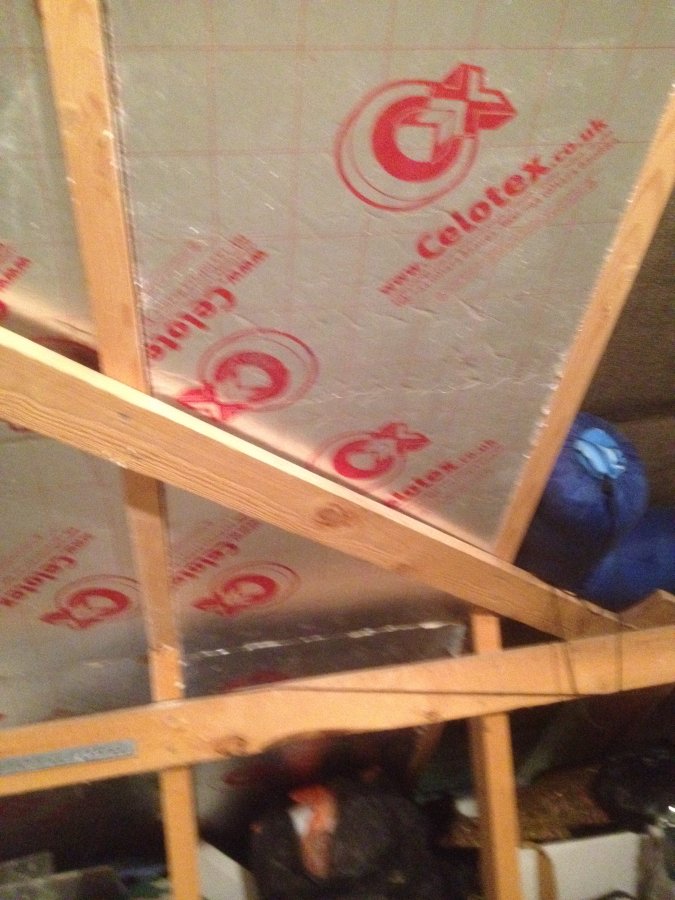

Hi all ,
I want to pick somebody's brains please.
With my rafters now insulated I am looking to fit plasterboard but I have 2 X diagonal braces across the rafters each end of the loft (4 in total)which are 25mm. How do I use 12.5 plasterboard on the rafters etc with the braces fixed across them ? In my mind I am thinking of 25mm batons all round the rafters to make roof all level to fix plasterboard
Your knowledge & experience appreciated

Sounds like you have trussed rafters, of which there are different types. Yours sound like attic trusses. These days diagonal bracing is used.
Battening out is one way to do it.

If they are trusses, why have you insulated at the 'rafter' level? That's a potential condensation risk to the roof void.
You won't be able to remove braces.

Think I'm confusing you , I'll take picture and show you so you know what I mean

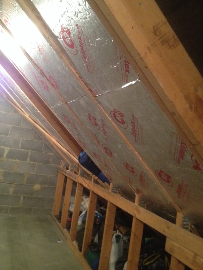

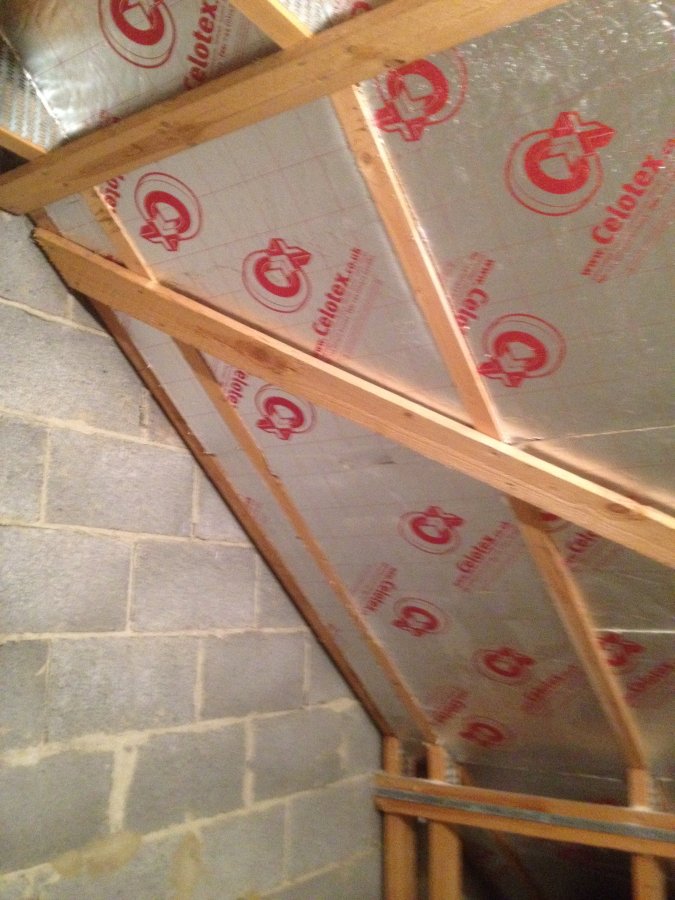

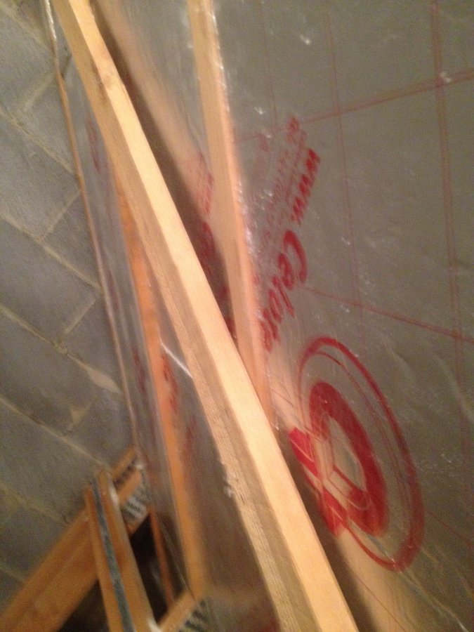

Here you go ,
The insulation is 100mm with 100mm air flow,the picture shows the braces going across which are 25mm

Oh, it's a loft then. :rolleyes:
No you can't remove those braces. And a ply diaphragm between the trusses is out of the question too in this case.
You need to batten out the trusses with 25mm tile battens and then plasterboard across the braces.
