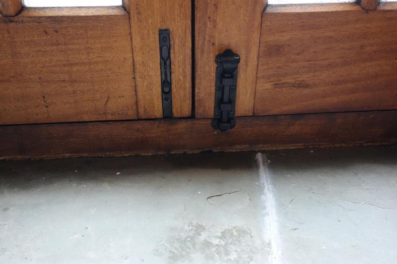

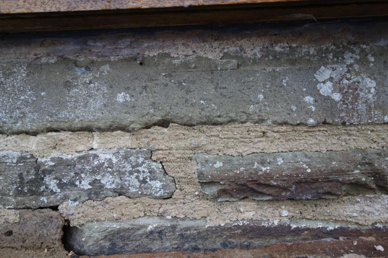

Hi all, I think I have fixed the problem I described, but I now have a different issue. Under the door frame there is a stone sill. Water seems to seep through this from the outside - I can't find any trace of rain getting through the door frame now. I've attached photos of the inside and outside. Hope these are clear enough. The wall is pointed with lime mortar. It needs a bit of attention in places as some of it has crumbled away in places but immediately under the door it seems OK. Would some lead flashing under the door sill on the outside be a good idea? Or any other suggestions? With a really bad weather forecast for the next week I'd like to find a fix for this quite soon! Thanks everyone.
no point just looking directly level on the outside
it could be anywere above that point and only coming to light at the bottom
look all round the frame and even under a window above
