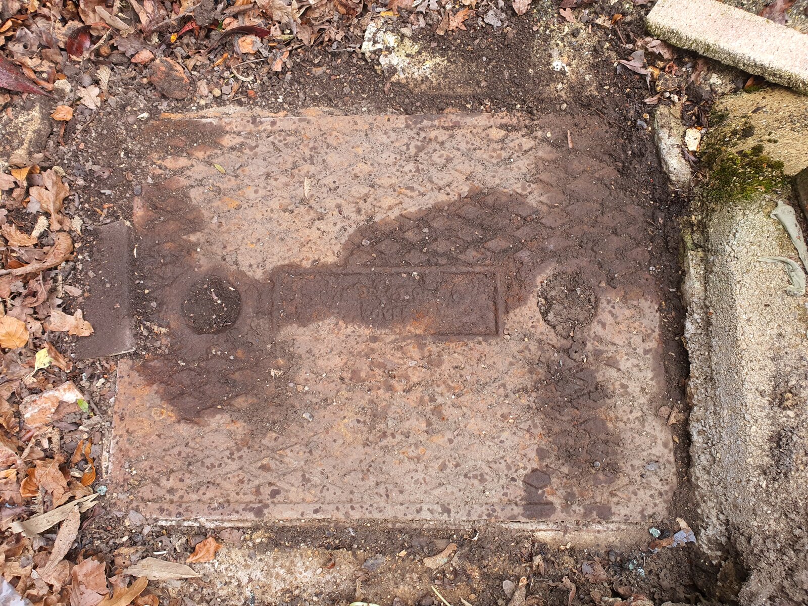

I've lifted a couple of loose pavers and can see a drain which I might be able to link into. The problem is, I don't know if it's a foul water drain or one for rainwater. Any idea how I find out?
Here's a pic of the drain cover but I'm not sure how useful it is.
1. Open the cover, flush a toilet and see if the water goes through.
2. If it does then its a foul drain. Might then be worth checking with the local water undertaking whether you are on a separate or mixed system. If on a mixed, you can run into the drain, if not and it is a foul drain, then you can't.

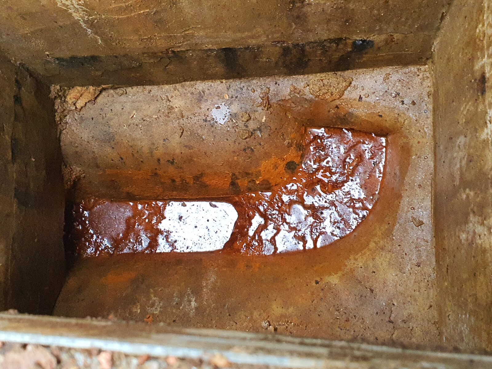

I took the drain cover off and flushed the toilet and it's definitely connected to the house waste system. It also looked to be about 4 feet deep. One feeding pipe into the chamber seemed to have a flap on it. This wasn't the one that was fed from my house flushing the toilet. I wonder what that one is?.
I'll have a chat to the neighbours and see if they know how their rainwater is connected.
Flap is probably a Rat Blocker, stops rats getting up the pipe. Need to ascertain where that other pipe is going to, to see if the drain is shared.
Otherwise, I'd say looking at that chamber, it's from the era of 'Combined' Drainage, where foul and rainwater were fed into the same sewer. If the site doesn't lend itself to digging a soakaway, (soil type, proximity to building etc), and there isn't a storm drain available, you may be permitted to connect into the sewer anyway.

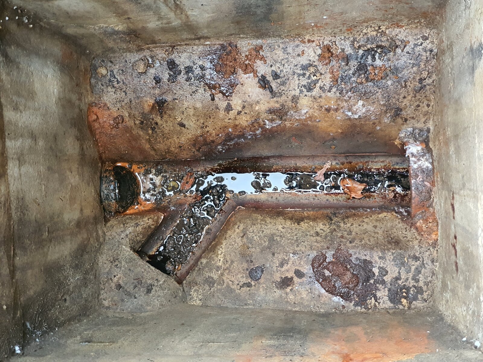

Bit of an update. I managed to lift the other drain, which is about 3m away. There isn't a feed into it, so I can only assume it's an overflow from the other drain.
I'll speak to my neighbours tomorrow to see if they know how their drains work. If I can't break into the foul water drain, I'm tempted to send the rainwater from my roof down under the decking into my garden.
I gave a soakaway some consideration but then I remembered that I have clay soil, so that's probably not an option.
