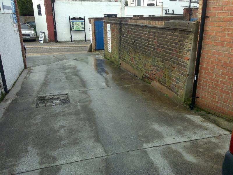

I own a business and have an alleyway to my property which my customers use. It is also shared by some shops for their rear access.
Within the last month one of the shops has installed a rain water pipe from their flat roof and it runs onto the alley (see photo)
I have a problem with this because when it rains It causes a nuisance because a large amount of water spreads across the alley and my customers have to walk directly through it. Also the water is coming off a flat roof and it takes ages to drain because the roof puddles so the outlet is running water for quite some time after its finished raining.
I have my own rain water pipe (left in the photo) which has been there since 1973 and the rain water comes from a pitched roof so its run off is quick. The water also runs close to my property. We gained permission in the 1970's for this to be installed.
The shop didn't ask permission from myself or any of the other shop keepers who use the alley and when I spoke to them about it they claim they have been having water coming into their shop causing damp in their storeroom so have re-routed the water off their roof.
As the water finally runs from the shared alley into the highway do they need permission from the water board/council?
Do I have the right to get it removed?
Any advice please would be gratefully received
Your neighbour should have had permission from the Local Authority to allow surface water to drain onto/across the pavement.
Up until a few years ago the LA used to ignore this even though it wasn't explicitly legal but now Planning Permission is required.
If the LA do not give permission an alternative such as a soakaway is required which is subject to Building Regs. Failing that permission to discharge to foul water drains is required from the local Water Board.
I would imagine the local council would support your concerns, not only are your customers having to traipse through the standing water, but during the cold weather this is down right dangerous, it is inconsiderate and antisocial. Let’s hope that your neighbours are well insured as this is an accident lawyers dream.

I thought as much. I did hear you need planning if you want to run surface water into the highway so thank you for confirming this.
Do you think my own water pipe will be an issue as the shop has said to me 'Well you have one so we copied you'?
Imagine if ever shop copied and did the same, we would have a river running :(

I'm not confident that my previous post was absolutely accurate or included all the considerations.
Planning Permission is now required for surface water discharge from a new hard standing to the pavement/highway. I can only assume that this applies to new surface water pipe discharge because it initially discharges to the hard standing and thence to the highway. Clarification may be needed.
My understanding is that up until about 1998 permission was not sought and the LA ignored instances of surface water discharge to the highway.
So you may have answered your own question. Yours was installed in 1973 and had permission.
However, i think that the LA could still take action under the 'Obstruction' rules. i.e. Surface water could be considered an obstruction to the highway.
Finally, you do not have the right to ask your neigbour to remove the pipe, only the owner of the shared alley has the right to require the 'owner' of the new pipe to dispose the surface water from his roof without inconvenience to others. ;) You should not willfully discharge surface water onto someone else's property.
The LA also have the right to take appropriate action to remove or prevent the discharge of water to the highway. However, and this is where it may get murky (pun intended), is the surface water the responsibility of the alley owner or the shop owner, once it's out of the pipe?

If, as you say, it is a shared access only, then the joint owners/users should be able to act as one and request the neighbour does not discharge water to your property. This should be enforceable.
