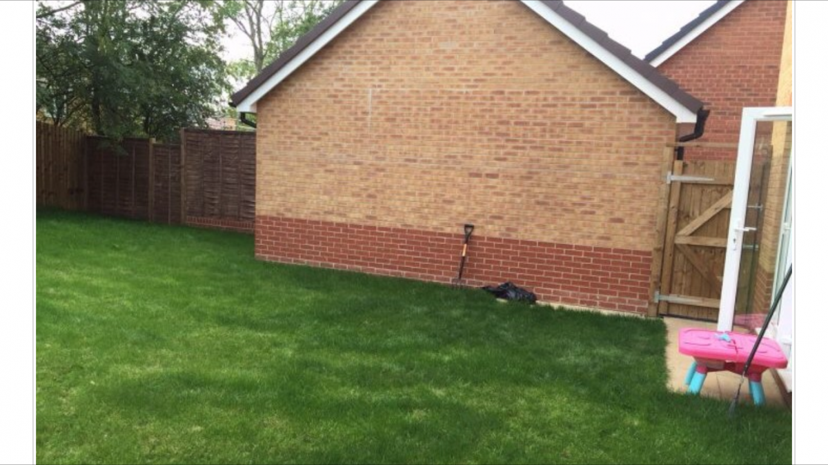

Is there likely to be any issue with the weight of the built up soil against the single skin wall? From current ground level the should be about 70cm up the wall?
Yes there is to be honest. thats why i was asking about the wall construction. if this was a free standing wall 70cm of soil would have it over in no time but because the garage has eight on the top of the wall in terms of a roof and returned corners it is stronger by a distance than a free standing wall but it is still only 4''.
I would say the risk is quite real but hard to quantify, can you post a sketch of the area including the size of the garage any piers in the garage wall and direction of any roof trusses/ rafters
The picture below shows the side in view of the garage - the built up level would be approx 2.3m down the side and then across the rear. Overall length of the garage is approx 6.7m

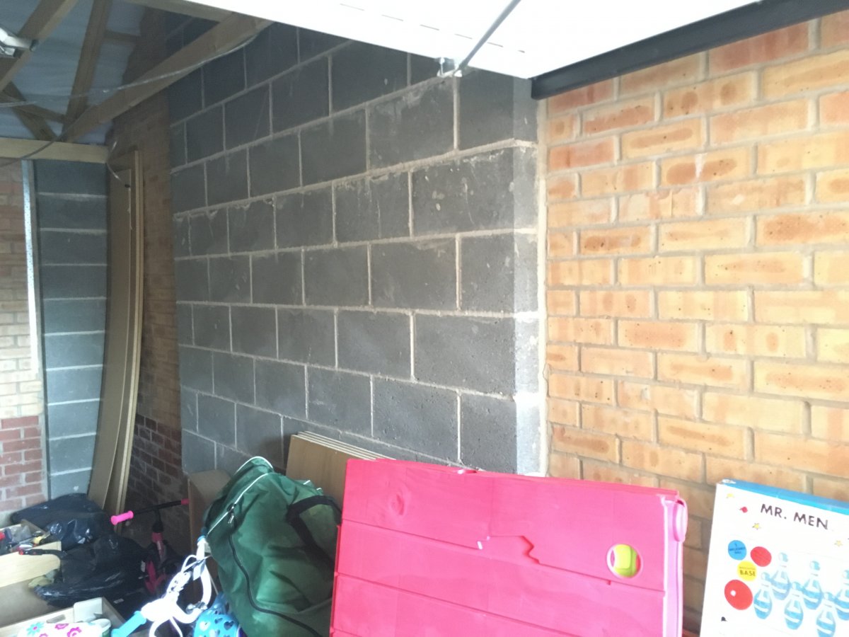

The garage is double skinned for a section in the middle, and each of the rear corners
If it was my own I'd go ahead but if it was a customer I would recommend on a separate wall.
Depending on how the footings were done you may be lucky and have room to build a second skin on the edge with a small 50mm cavity between. This would be an easy way to make it much stronger and more secure waterproofing.
The other option would be using some scaffold planks or 6x2s to spread the load and protect the dpm. Although obviously not as good as the wall.
I don't really think the strength of the wall is an issue given the double skinned sections and returned corners.
A ventilated cavity is the most secure way to keep the wall dry although as its only a garage some rolls of dpc should be enough.
