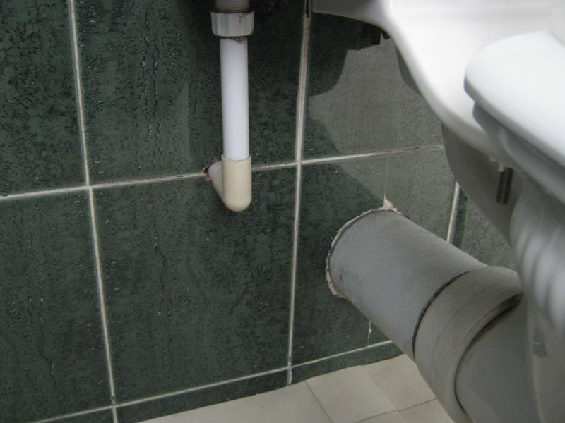

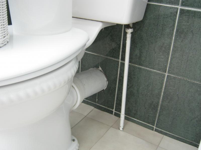

Currently have vinyl flooring in the bathroom which is to be replaced with ceramic tiles.
Could I ask what is involved in raising the toilet pan and cistern to allow the tiling to be laid before re-fixing the toilet?
I have included a couple of pictures of the existing set up, I am unsure how to proceed with this and will probably get a plumber to carry it out but I would be interested in finding out what is involved and how it will be done.
Remove the toilet and get an off set bend.
I take it you are placing ply on the floor then tiling.
Andy
Also cistern will have to be raised with the pan,overflow and cold feed will need extending aswell.
