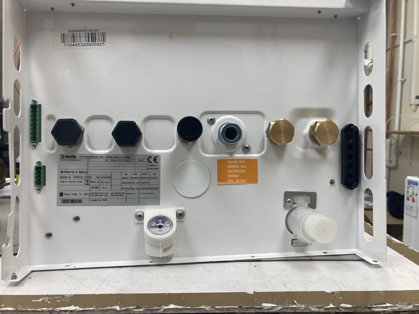

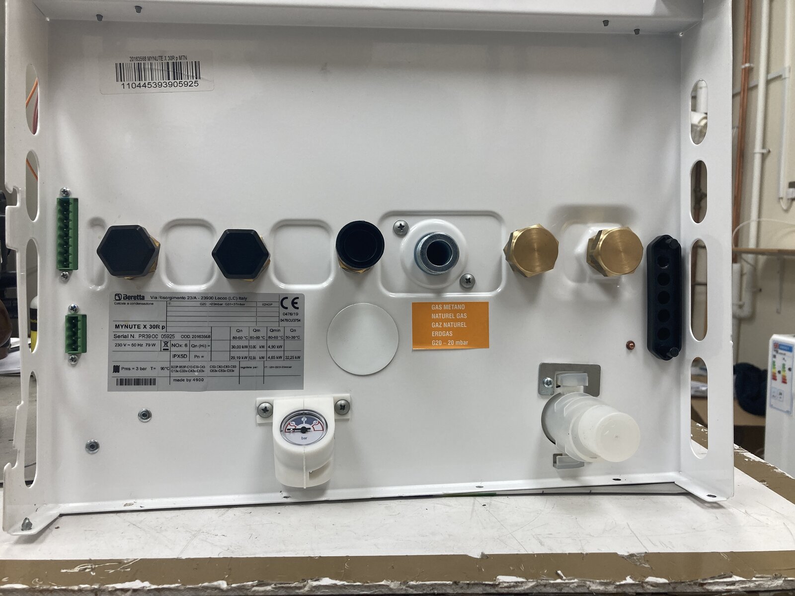

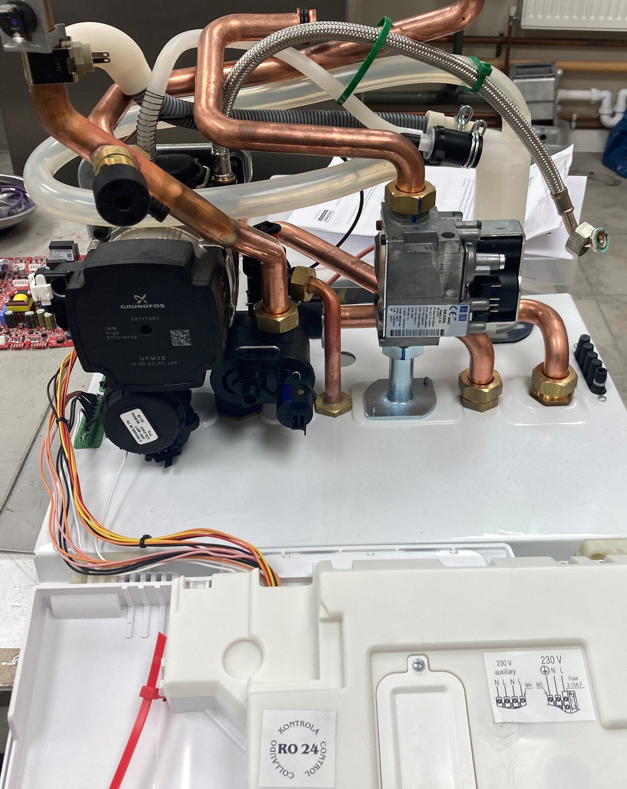

Can you tell me the boiler model number please - is it available in the EU e.g. Rep of Ireland?
I don't imagine it would be available in the UK or Ireland but probably Italy.
The boilers are sold as Beretta and the model would be the Mynute X R
Basically a Vision Plus S but a 4 pipe boiler with a F&R for heating and separate F&R for cylinder reheat.
I have suggested to product we need this in the range but it fell on deaf ears
