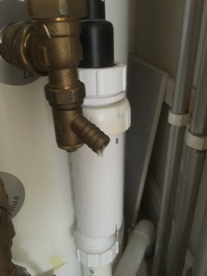

I have got water dripping from cold feed drain elbow for a long time. I tried to tighten it, but it doesn't work. Then put a small container under it. Any idea of how to fix it? Thanks!
A king edward should do that nicely or you could drain the cylinder and put a new rubber washer in the drain cock.
Hi Picasso, Thank you for your quick reply! Do you have info of how to drain water cylinder? It seems there are limescales from cold inlet.
Turn off the supply to the cylinder, stick a hose on the bit thats dripping, loosen the bit you have been tightening and the cylinder should drain.
