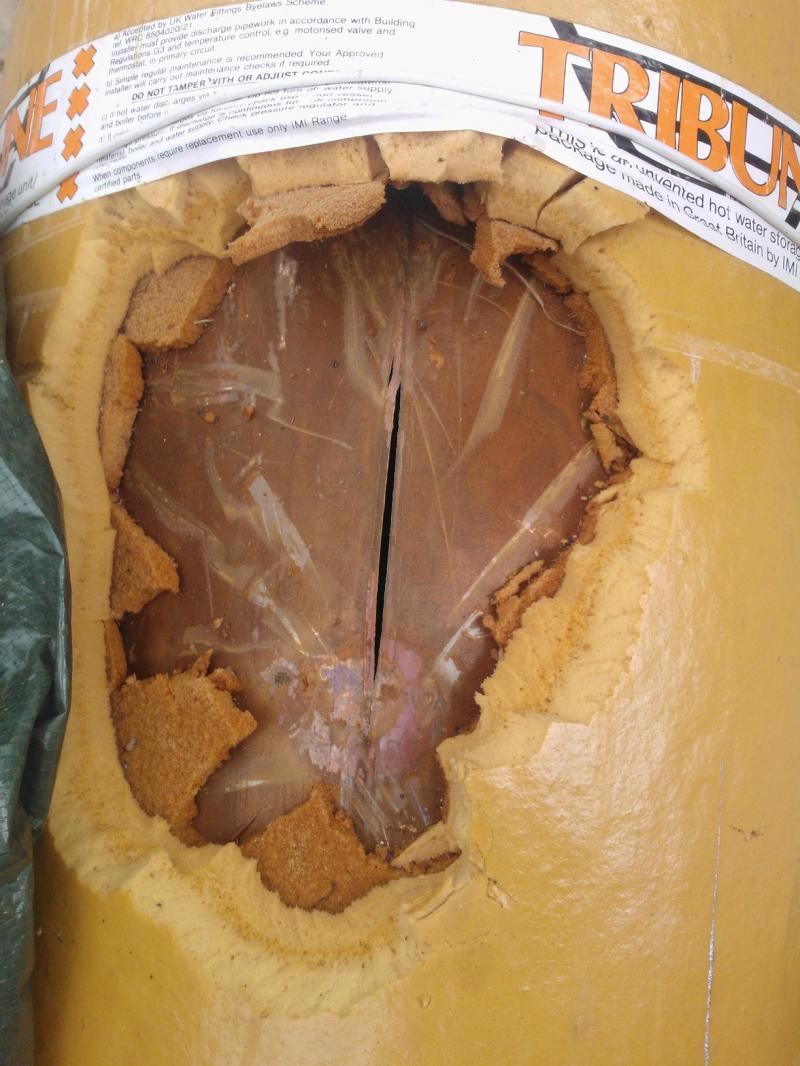

Can anyone help me with a huge issue.
I have a Range Tribune HE water heater in my rented property that I live in.
There is no instruction manual and the heater itself confuses the bell out of me as I don’t know what the green dial is for or the two white ones top and bottom. Also, what is the white ball shaped tank attached to the top of the water heater ?
The only thing I know for sure is that my electricity bills are through the roof and I am now in debt to the electricity supplier, so have switched the thing off from the main box

The only thing I can find is the installation guide which tells me absolutely nothing about how to regulate it.
If the two white things are immersions, how do you use them?

You don't touch those immersion heaters.
Normally with a cylinder heated by electricity you would have a duel tariff contract.
The heater towards the top is only ever switched on to top up the cylinder if you run out of hot water during the day as that would use higher rate electric.
The lower heater (to heat the whole cylinder) would be timed to come on overnight depending on your cheaper rate electric hours.
Post pictures of any timeclocks/switched and the electric meters.
