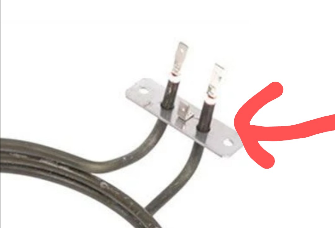

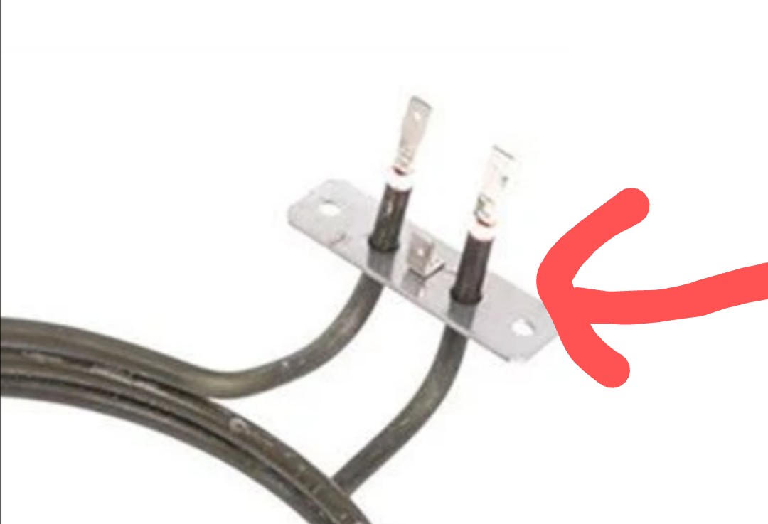

One last thing. I noticed when replacing the element that there was a piece of what seems like foam between the element and the back oven wall. I presume this was like a cushion between the element in the back wall. Unfortunately this has perished so does it need replacing? See attached image
Thanks again
Is it available as a spare, if so it sounds like it may be just a gasket to stop any vibrations affecting the element. That's just a guess though hopefully gasbanni will tell you for certain.
