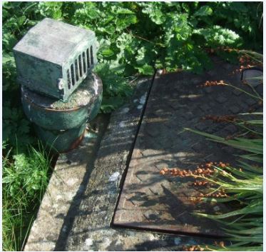

It looks just like this one
As I thought - a inlet to an old fashioned system - the manhole most likely has an interceptor ( buchan ) trap . Lots of posts about them on diynot. The inlet can be sealed off - knock it off and cement up the pipe. Have the manhole cover up so you don't get broken bits falling in as you sort out the old inlet. Somewhere there should be a tall vent pipe going up + above the roof. The idea was air in your low level inlet - then out of the tall vent . The main sewer was supposed to be kept separate by your interceptor trap . All old and pointless now. As long as you have the tall open vent you are fine.;);)

I'd echo everything Nige has said, and I suspect this vent is the cause of your whiffy garage. These vents were designed with a Mica flap inside that was supposed to act as a one way valve, to allow fresh air into the system, but keep smells out. They invariably fail, (usually open) and this is the result. Pic of the manhole may help, the associated pipe to these vents is usually one or 2 bricks down from the top of the chamber.

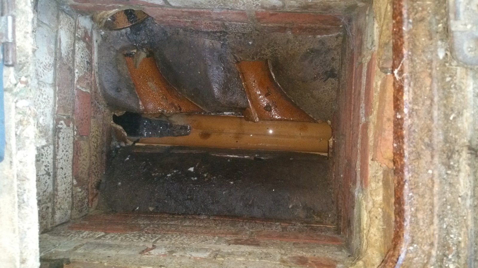

Hi all
here is a pic of inside the manhole and a pic of the location of the manhole with the vent and ex-rainwater drain with the washing machine outlet. These are all inside the garage
To the left of the manhole the pipe goes to a rainwater grate, the kitchen sink also drains into this via a pvc pipe.
Behind the wall in the pic is the bathroom
To the right is the driveway with another manhole which only has 1 in and 1 out and then the road
I can see now - someone built your garage onto the side of the house,and not wanting to penetrate the new roof with the existing tall vent pipe, they tore it down and put that inlet "valve" in it's place:idea:
Think Nige has hit the nail on the head. It appears the drain continues upstream of the manhole in the picture, does any of the pipework upstream re emerge from the garage do you know? (You mention another gulley etc, any of this outside the garage footprint?)
I'm looking at options for reinstating the vent, with minimal hassle, and then the existing can be blocked off inside the chamber, and at floor level in the garage. Ratty will have to find another exit and your garage will smell somewhat sweeter.
