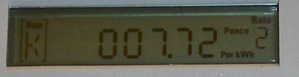

You don't need to; EFL did it for you. The higher price per unit will be the day rate, and the lower, the night rate.
Of course, you could contact Scottish Power, and ask them.
Yes, but EFLI's piccie was not of the OP's meter, which may well not display the prices per unit (my dual-rate E7 meter certainly doesn't). Indeed, unless it's a 'smart meter', I can't see how it could know anything about prices (which are changing all the time).
Kind Regards, John
Fair point John, but the OP said he couldn't post a picture, not that it didn't show the same info - admittedly, he may not have got past the couldn't post a picture thought, so didn't go and look.
The picture was not a smart meter but was a Scottish and Southern pre-payment meter.
Perhaps they can be set with and do show the rates and 'ordinary' ones do not.
The picture was not a smart meter but was a Scottish and Southern pre-payment meter. Perhaps they can be set with and do show the rates and 'ordinary' ones do not.
Ah - that makes a lot more sense, but may well not be relevant to the OP's meter.
As I said before, it would not really make sense for a non-smart meter to display prices, since they would then have to send someone (and probably someone 'more' than just a 'meter reader') out to each of the customers to change things every time the price changed!
