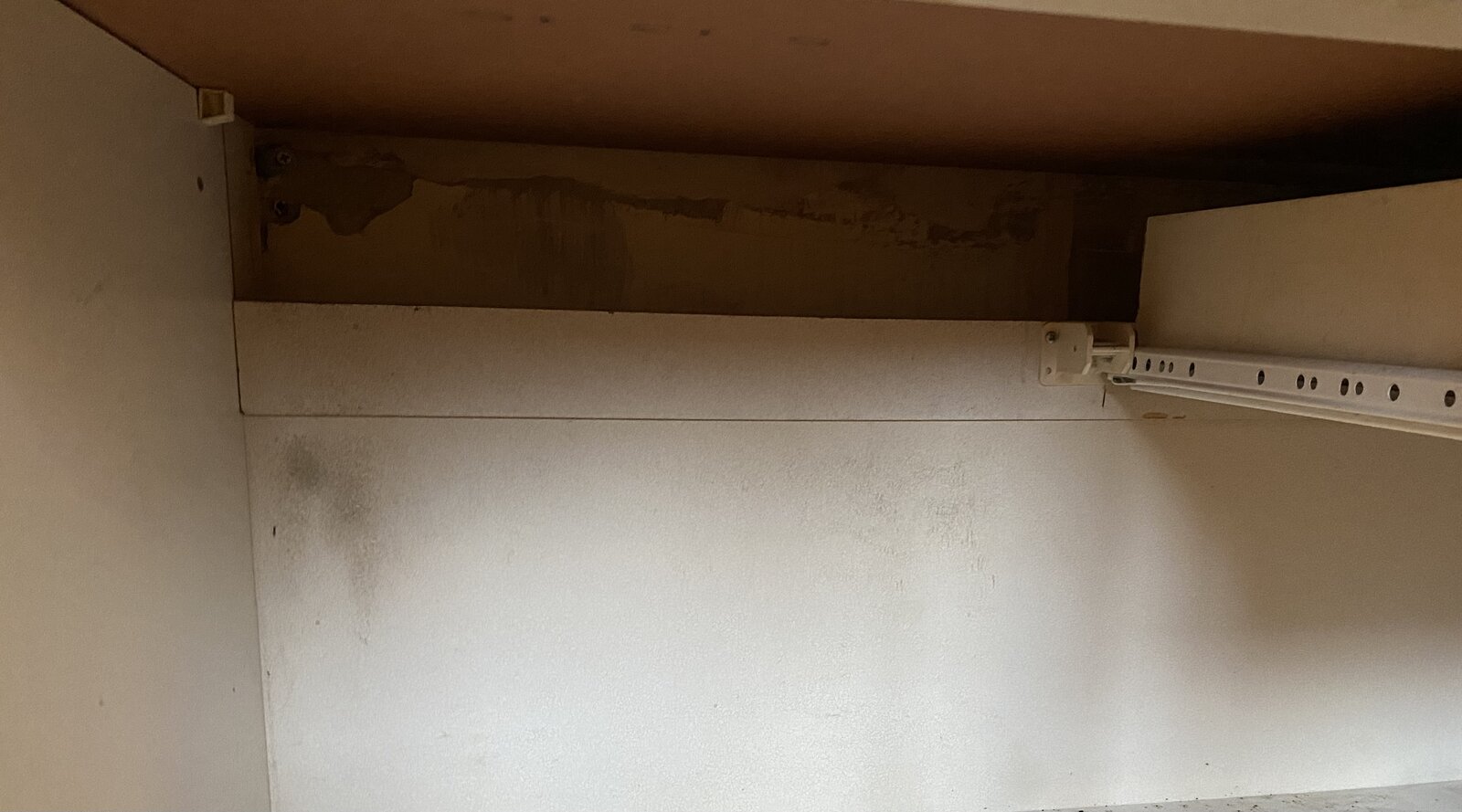

Got a rat problem which I would appreciate any advice on please. I noticed lots of chew marks in some food in one of my lower kitchen cupboards, they’ve been climbing in over the back rather than using the doors. Can even see the claw marks on the walls which is gross.

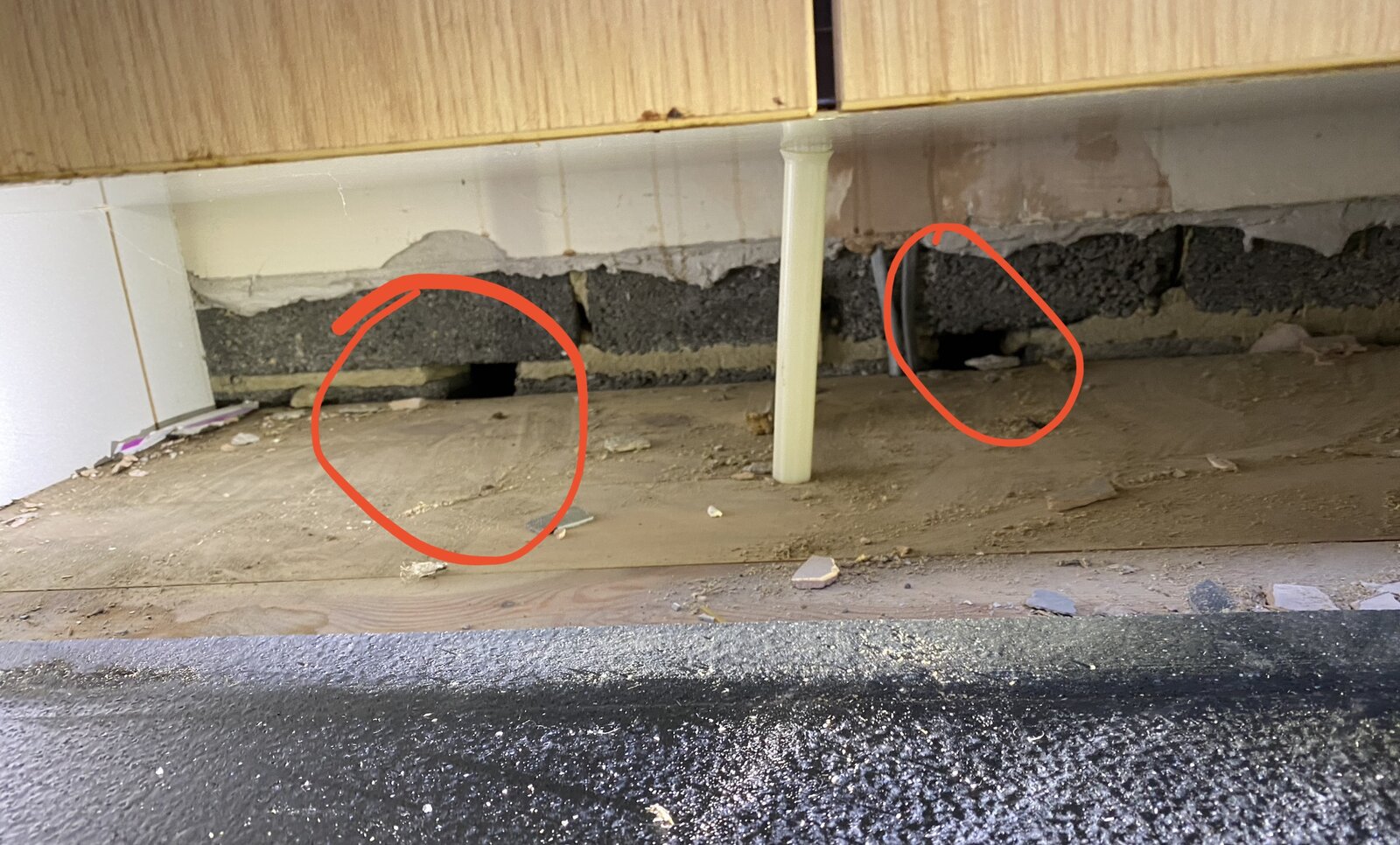

I had a look behind the kickboards and the obvious thing that stuck out were these gaps in the blockwork. Could feel the breeze from the cavity.

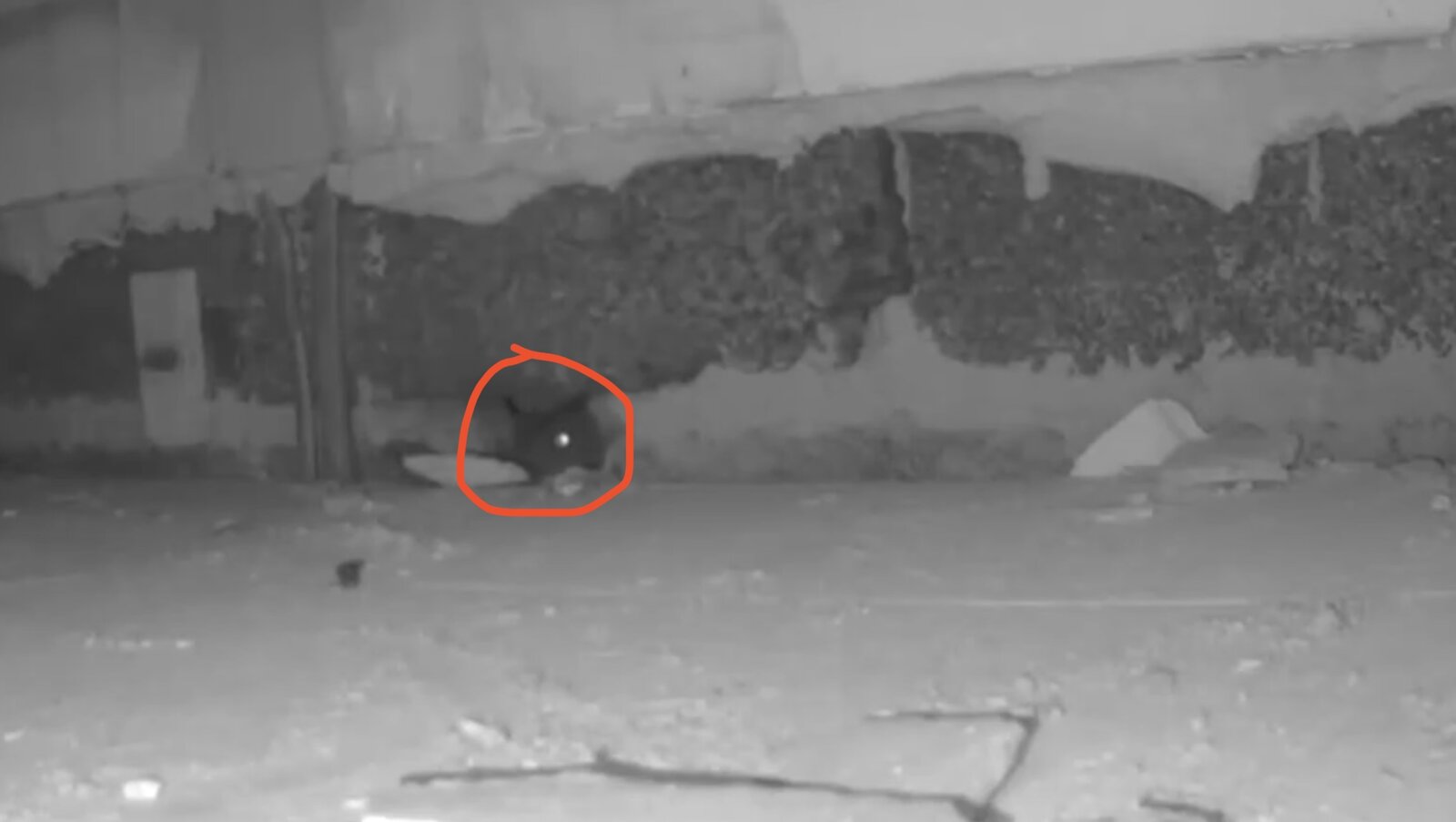

Put some traps out and set up a motion activated camera and lo and behold it showed its head in the gap.

1. Are there any reasons for gaps in the blockwork like that? Is this pattern of gaps likely to extend along the first floor?

3. How best should I fill those gaps? I know wire wool can be a short term fix, but the gaps are probably too large for that and would prefer a more permanent solution.

Gaps are possibly where the joists for the floor are (if it's a suspended floor) if they are they will be all along the room, something like 400mm apart.
You won't be able to use expanding foam, will be difficult to get in, and they might eat through it.
I think I would cut some plywood squares and glue over the gaps, with a good adhesive. They can gnaw through some meshes.

Poke some mortar into the holes. Or stuff them with wire wool or one of those metal brillo pads, then pump in a few squirts of silicone to hold it in place.
