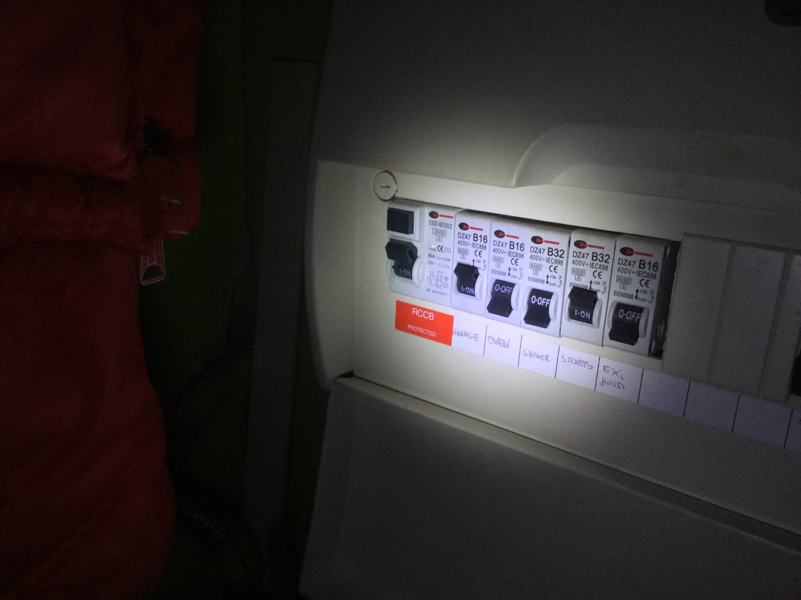

We are having problems with nuisance RCCB trips. When it trips, we re-set and appears ok for a while (maybe hours) then trips again.
We’ve tried to isolate the issue but can’t seem to track down the problem. I would like to understand some basics about our consumer unit to see if I am doing the right things. We didn’t install it so would like to confirm my understanding.
I’ve attached some images of the consumer unit. I believe the RCCB protects everything except the lights. There are 5 switches (MCBs?). There are marked and I understand they are for the following;
1. Garage - seperate garage. Cable is underground. We have an overflow fridge freezer and outside spot light plugged in there. I isolated this area before and still had tripping issues. We’re using the freezer currently as the other one needs replacing (see below).
2. Oven/Hob - to one socket which has plugs for gas hob ignition and electric oven. The oven only requires 13 amp plug into a standard socket. This is currently switched off.
3. Shower - I believe this is redundant as we have don’t have an electric shower but one that works off a direct hot water feed from the combi boiler. I’ve currently switched this off.
4. Cooker Hood and Wall fan in kitchen. This is currently switched off.
5. All Sockets upstairs and downstairs

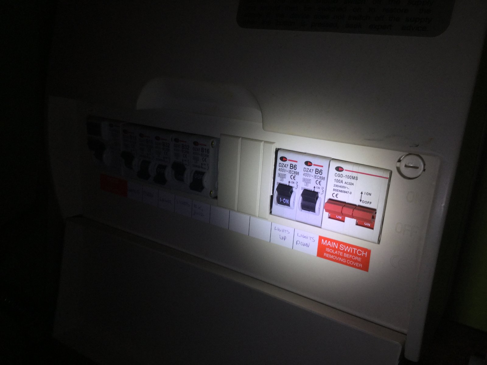

As you can see, there are 2 switches (MCBs?) for the lights, one for upstairs and one for downstairs.
None of the MCBs have ever tripped. The RCCB trips and everything goes off except the lights.

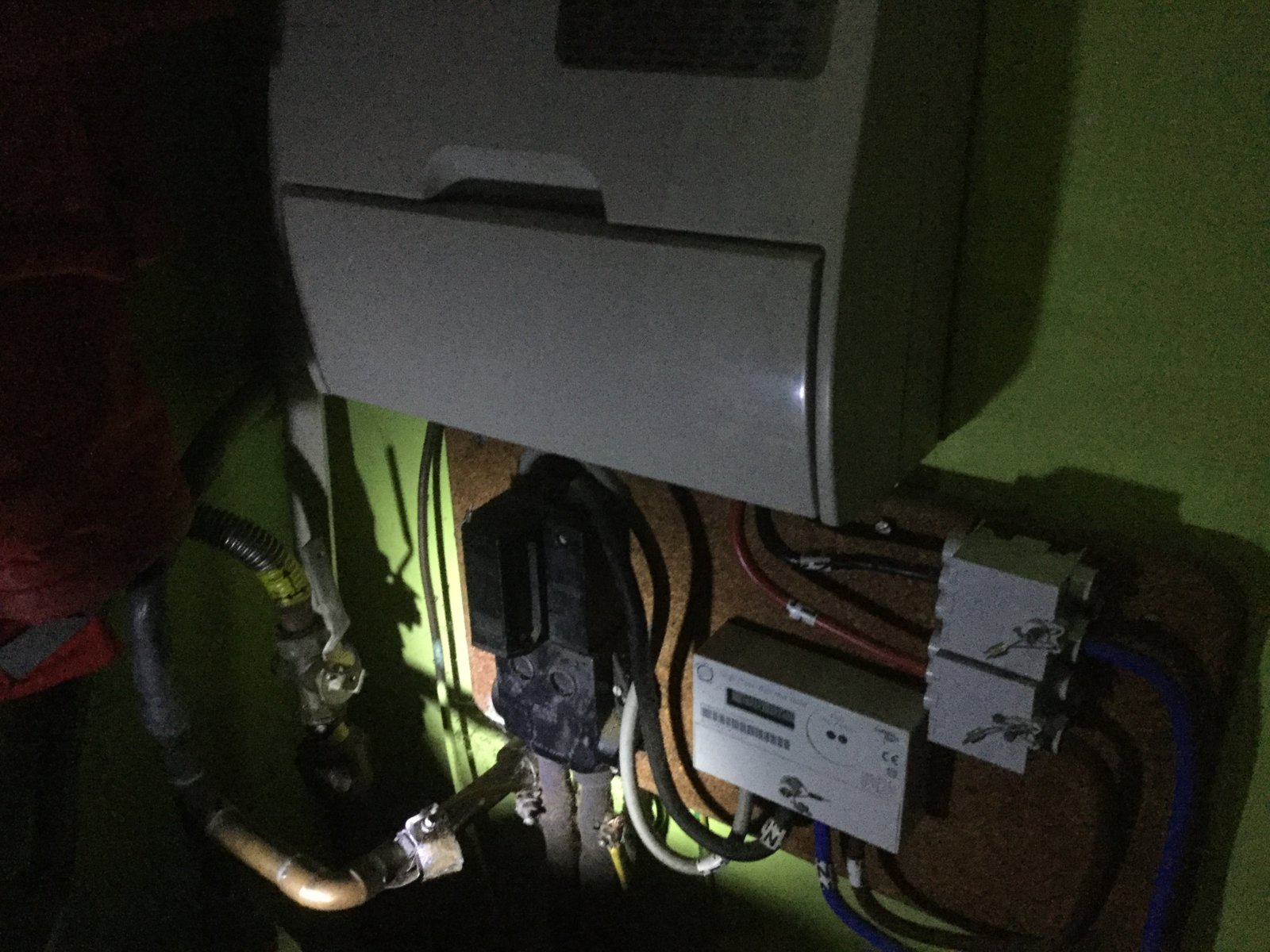

c. The boiler does not have a plug as it’s hard wired into a fused switch which is connected to the sockets circuit. This is a new boiler fitted about two months ago and despite the fact that it has worked ok I want to isolate it. Am I able to isolate the boiler by switching it off or should I also remove the fuse from the switch?

At 5am I switched the power to the boiler off. Turned it back on about an hour ago. Boiler has been working and heating up the house in the last hour. No tripping....
We spoke to one electrician a week or so ago who said it was pointless coming until we’d identified where the problem was. We’ll get someone in to check the boiler electrics first under the warranty despite the fact it appeared to be all working ok up to a couple of weeks ago and has been ok in the last hour.

When I am investigating random tripping I always look at possible water related problems first, leaky pipes, outdoor kit, etc, also be aware that isolating a circuit using the MCB leaves the neutral connected, a neutral - earth short will trip the RCD
If I switch off any of the 5 switches then that circuit is completely isolated and if a trip occurs then appliances on that circuit cannot be causing it?
Incorrect, the MCB ( switch ) only disconnects the Live of that circuit, the Neutral is still connected, A Neutral to Earth fault on a circuit can trip the RCCD when the Live to that circuit is isolated.
As Bernard has pointed out, Isolated means disconnecting the LINE and NEUTRAL connections. Just turning off the MCB will not isolate teh circuit.
To do it, you are going to have to get inside that consumer unit and start removing cables.
Or get an electrician with an Insulation Resistance Tester to identify the fault for you.

Finding Neutral to Earth faults does require the electrician to disconnect the Neutrals inside the consumer unit before doing the testing.
A Neutral to Earth fault on a circuit with the Live switched OFF may not cause the RCD to trip until a load on a different circuit is switched on. This can mislead people ( including some "electricians )as to where the fault is.
For example the RCD trips when a kettle or toaster on the kitchen socket circuit is switched on. This suggests that there is a fault on that socket circuit when the fault is actually a fault on another, possibly isolated for testing, circuit.
Not necessarily quite true depending on budget.
They could change over all the MCBs to rcbos which would narrow down which circuit had the problem and also remove the possibly of losing power to the rest.
However that would cost a bit even assuming they're available for your unit.
